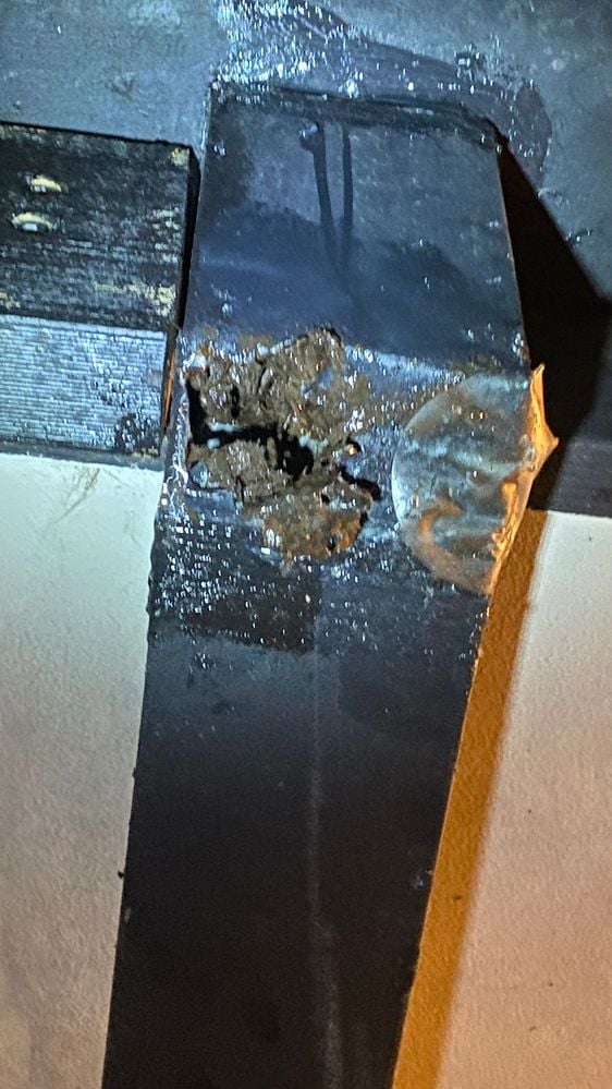

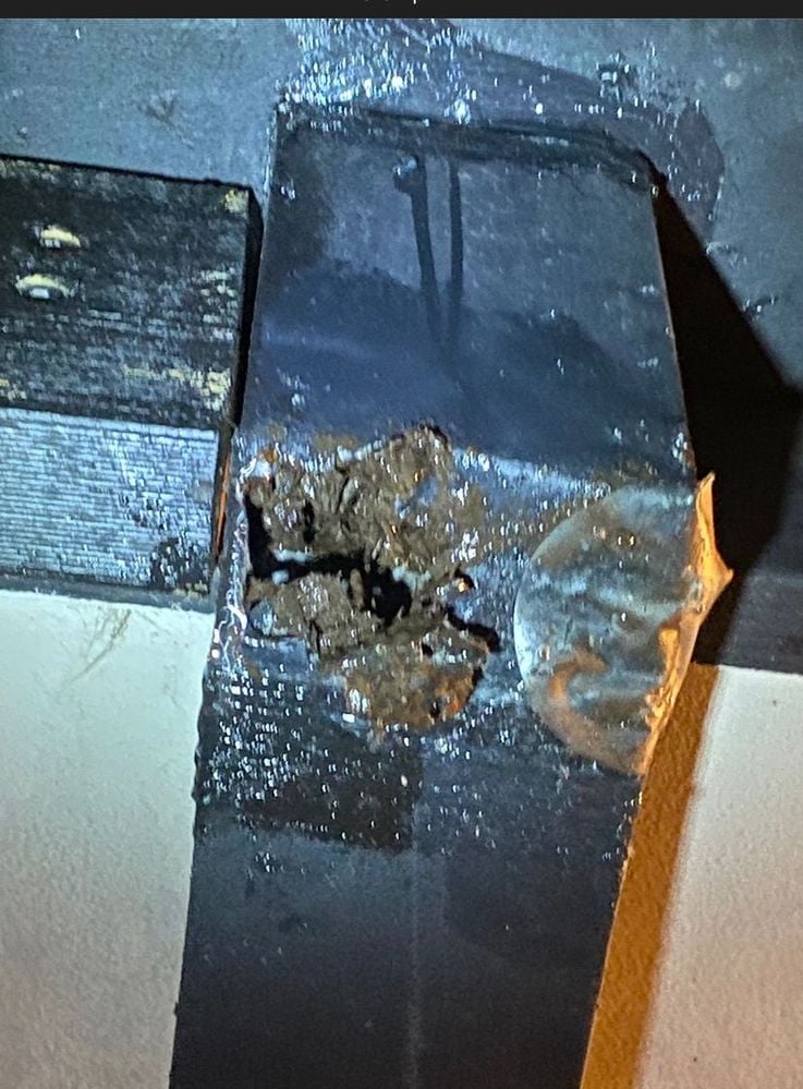

I am after some advice on fixing and replacing a rusted hole in the down pipe at my house.
As per the pictures, after the large amounts of we have had recently and the elbow join of the down pipe being clogged with mud and dirt etc, a small hole had rusted through the elbow join on my down pipe outside, and rain is pouring through the hole.
1) What's the best way to remove the section of the existing downpipe?
2) How do I install a new bit.
Mud and dirt clogged in the down pipe

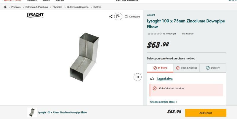

The part you're after is called the Lysaght 100 x 75mm Zincalume Downpipe Elbow. Typically the defective elbow is cut off using tin snips and the repair piece is inserted into the old downpipe by folding its sides. I suggest using Selleys 290ml Grey Storm Waterproof Gutter And Roof Sealant to seal the edges in combination with blind rivets to keep everything together.
My best advice is to match the angle of your current elbow and cut only what you need so that you have room to adjust when you fit the new elbow in. I've placed a diagram below to give you an idea of how the repair can be carried out.
I can’t seem to find the part 100 x 75mm Zincalume Downpipe Elbow on the website
Hi @Jason
I've noticed this a few times now. Eric's link worked fine earlier this morning - but just now all I see is the 'snag'. Nice pun.
Any idea why that happens?
But I do believe this is the product Eric was referring to.
I/N 4790438.
Thanks @Noyade.
I have reported the issue to our digital team. The product can be found using a search on the site but the direct URL isn't working, suggesting an indexing issue.

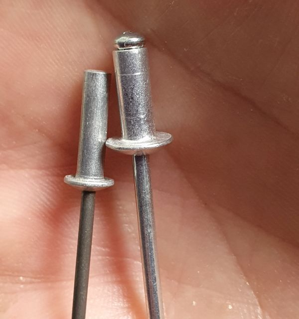

Hi @EricL I always thought the one on the left is a "blind" rivet and the best for guttering? I could well be wrong...
Speaking of pop-rivets - I've noticed over the years the area where they're sold in Bunnings is forever shrinking - limited choice now.
Are pop-rivets on the way out these days - it's all silicone glue now?
We should have a pretty decent selection @Noyade. However, I must admit I'm one of those people that can never find one of my several pop-rivet guns when I need it, so I typically just purchase another rivet gun set that includes several different sized rivets.
