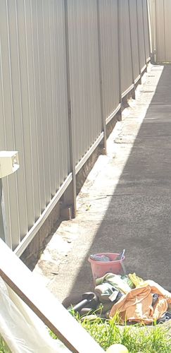

Hello, What can I put under my fence to cover these gaps? Thank you
? Thanks

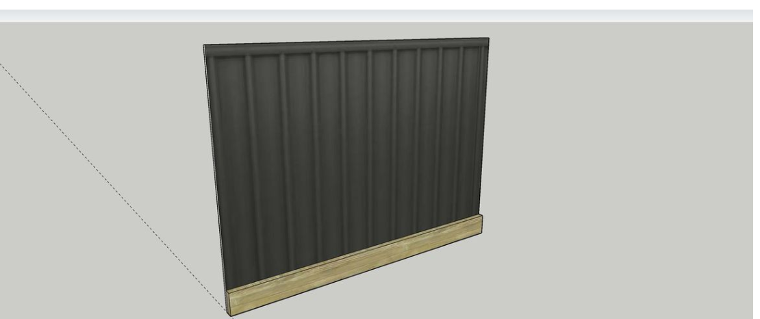

Hi Jason, I've had a read of all 3. I like Erics idea in post #2 (see pic below) about using treated pine sleepers with galvanised pegs. How would this option work even if my ground is all concrete? as ive read all 3 posts and all of them have dirt. Thank you
Hello @Glorz
I suggest anchoring the sleepers to the Colorbond posts with angled brackets. This will prevent them from falling over, you also have the option of anchoring them to the concrete floor with Dynabolts in combination with the brackets. This is on the condition that the concrete floor is thick enough.

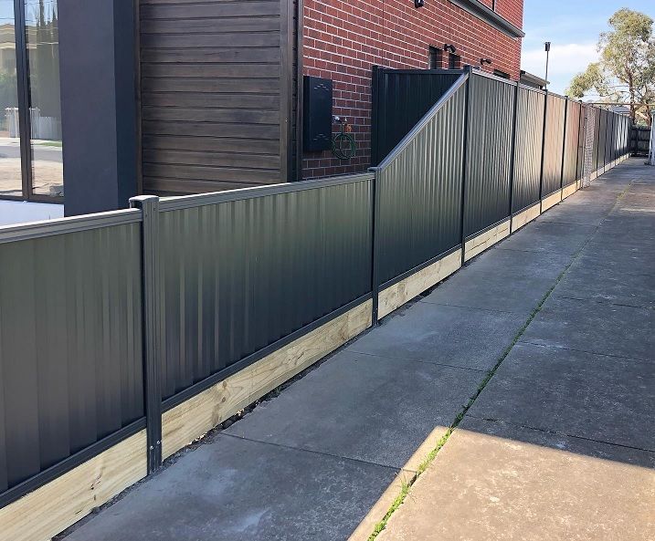

Hello @Glorz placing wooden sleepers at the base of Colorbond fences has become quite popular, predominantly from what I have noted people opt to use the existing Colorbond upright channeling (as seen in the image below), whilst it might be considered more aesthetically pleasing it would require the removal of panels to install the base board.
Hi @DIYGnome ,
This is the look I would have loved to achieve! Unfortunately removing the fence panels isn't an option so trying to find another way around it to achieve a similar look while also closing the gap.
@EricL's suggestion of using angle brackets would be the next best option. Cut the sleepers to be slightly shorter than the length of the gap and adjust their height if needed. The brackets will allow you to fix the sleeper in position. That wouldn't be as neat an install as sliding the sleeper within the posts channel, but it would be a reasonable option if you cut the sleeper to suit the gap size exactly.

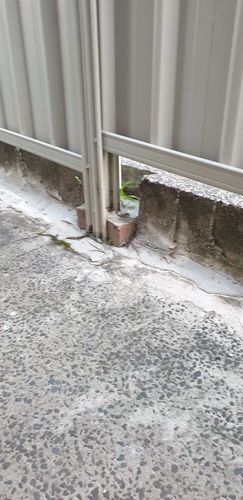

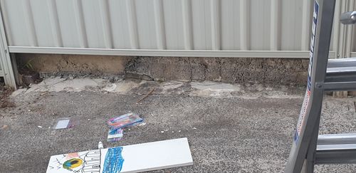

Hi @MitchellMc , the height of the gap is around 300mm. Sleepers only come in 200mm so there will still be a gap. Is my only option to close the gap completely is to buy another sleeper, cut it and stack it on top? thanks
Sounds like it @Glorz. Alternatively, you could install one sleeper between the posts and then a 150mm plinth across the front of the posts to cover the gap. That wouldn't look as neat as the stacked sleeper option, but it would save you from having to cut them down.
