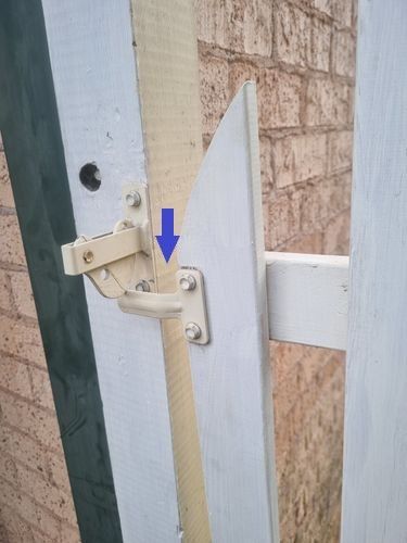

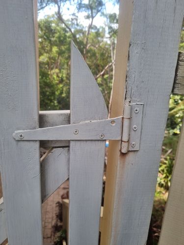

My gate has dropped slightly, works perfectly but this means with this type of latch, the bottom catch isn't clicking into place. Would it be easier to unscrew painted in hinges and somehow reseat them level, OR just buy a normal slide bolt and add that?

Thats very kind of you Noyade - I'm not sure a mending t-plate would work as its thr hinges that have drooped a tad, so it has to be hinged. But thanks for the kind seasonal gesture.

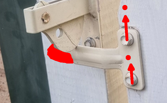

Would moving the two latch screw positions higher help?

I would just drop the latch down.

A big nose boop to Sir Sprocket from myself and foster boi Maxie. Dropping the latch is a good idea, as long as I can get those painted over screws out.

I can't add more to the excellent suggestions made by @Noyade and @AlanM52. I recommend filling the old screw holes with Parfix 500g Ready To Use Multipurpose Filler - 500g to prevent water from settling inside.
