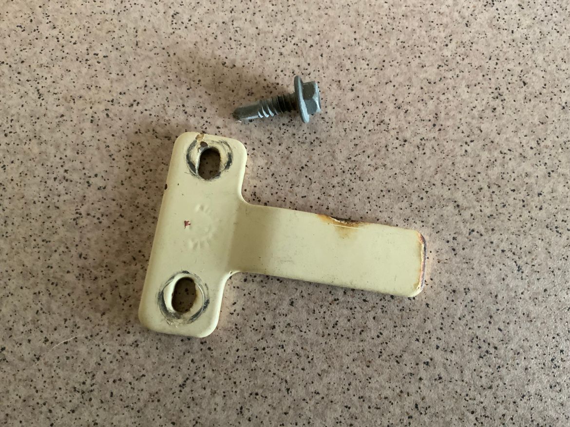

I’ve got a metal fence where the gate latch has disconnected from the metal gate post. Where the latch screws into the post looks to me like over time has worn the hole and now the the screw does not grip in to the existing hole (hope I’m making sense). Is it just a matter of getting a larger screw and drilling it into the post, or is there another way of securing the screw into the now too large hole? See photo attached of the latch and screws.

I propose moving the entire gate latch assembly 2cm hinger on the post and gate. The distance will still be the same, but you will now have a fresh area to install into. This will save you from having to patch or attach any secondary plate on the surface of your gate and post.

@Noyade is a resident anything metal expert, but for what it's worth I would drill new holes just inside of the original ones as pictured. They want be elongated as per the original ones which have the benefit of slight adjustment.

My thoughts are with you simply use a larger screw like the next size up and if needed drill out the latch holes.
Assuming you have a cordless drill with torque settings and the speed set to low (Screw) not high (Drill) and...a correctly fitting hex bit.
Start with a low torque setting and wind up until the screw starts to bite, click up one more and it should drive nicely.
