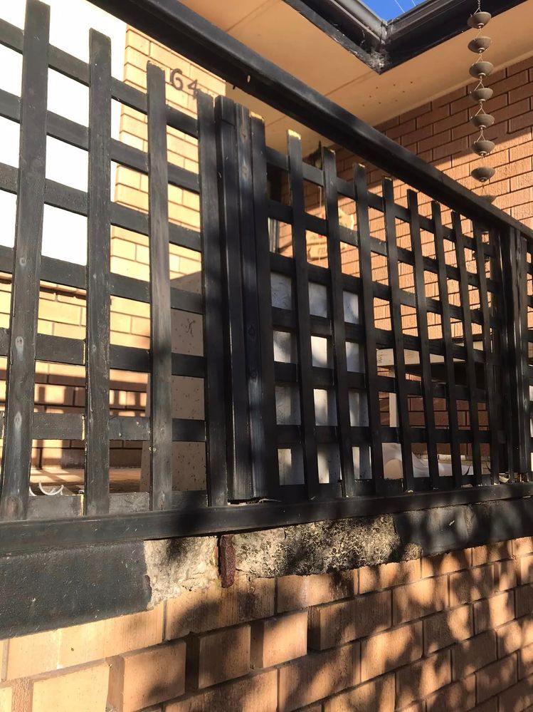

I have an issue with my patio and handrail.
The Steel posts that were originally concreted into to the actual concrete slab have expanded with rust and cracked the concrete slab to a point where there are wedge shape gaps of concrete missing.

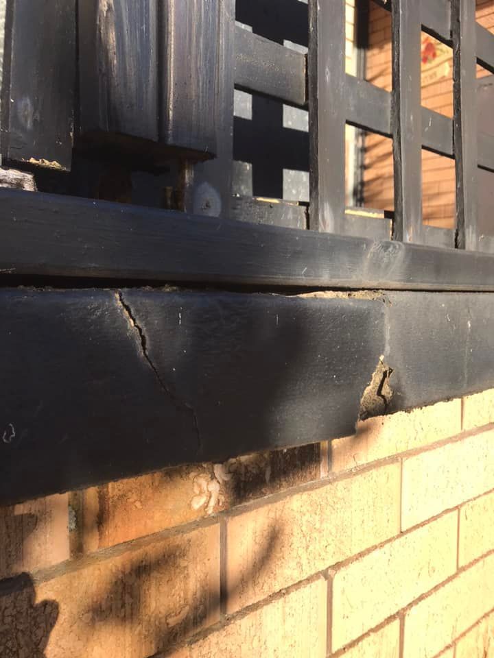

First Crack/wedge

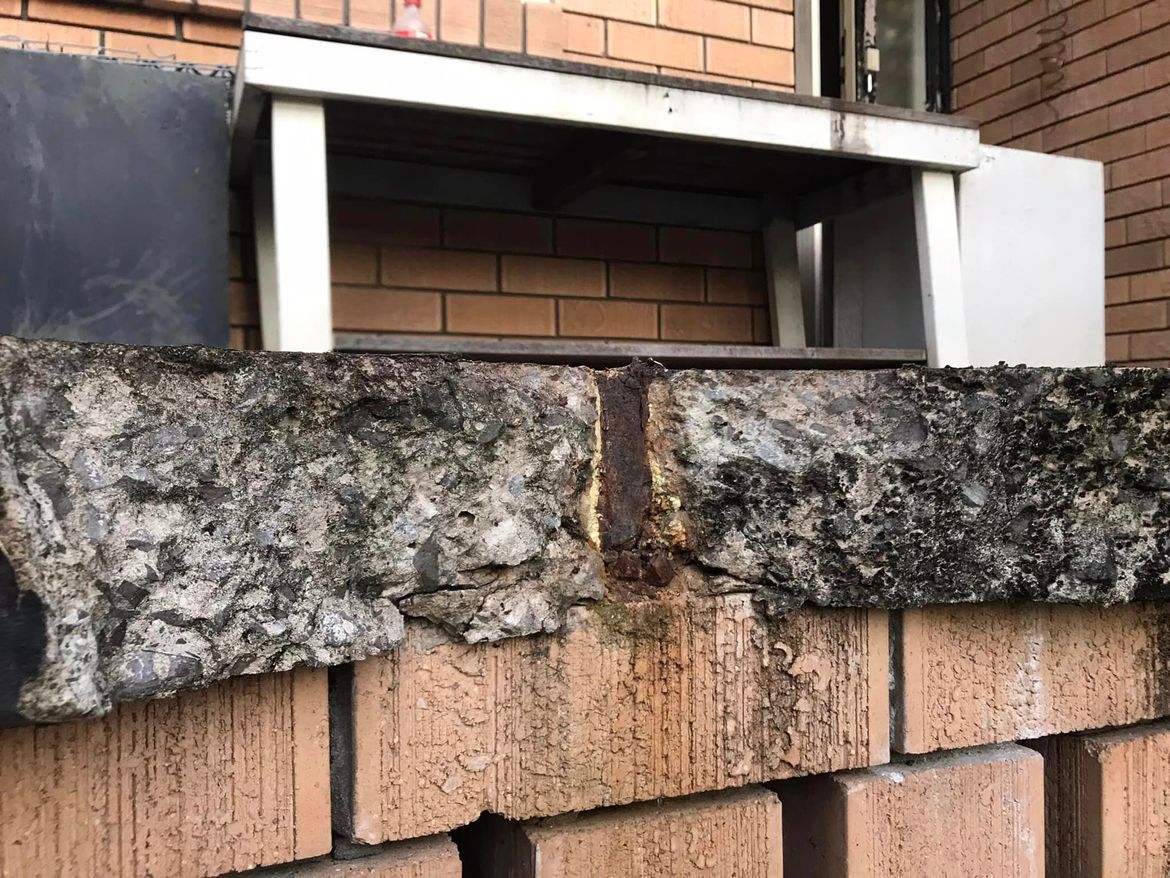

Second crack and wedge

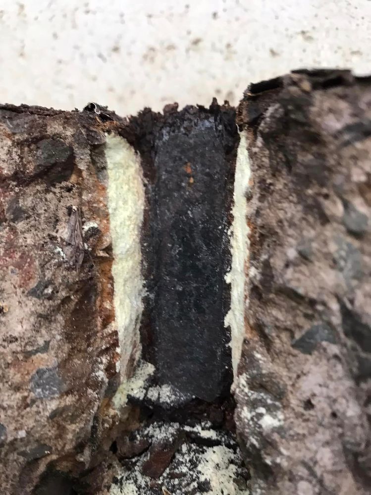

I havnt cleaned the area up yet. One question is does anyone know what that yellow powder is? I will use a cold chisel to take out loose pieces of concrete, then drill and fix anchors and then put some right angled formwork (Never done that before) to hold the concrete mix in. Is there something you put on the timber/proper formwork material to make it non stick?

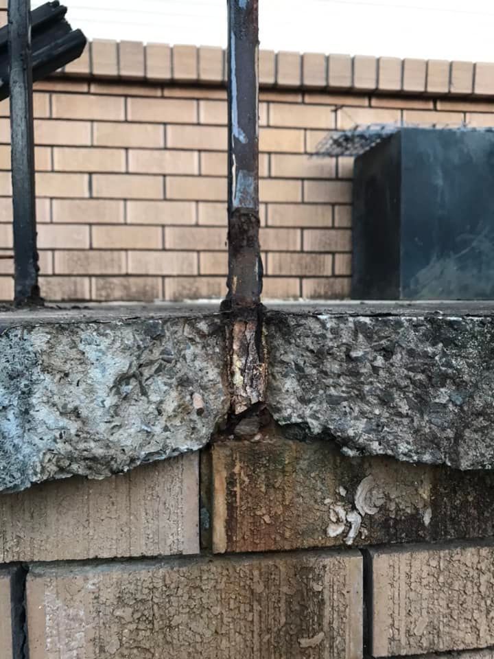

Old post before I tapped it out.
This is the rust and yellow powder? I thought maybe a byproduct of rust? Really dont know. There is another crack in another post but that has not expanded yet.
