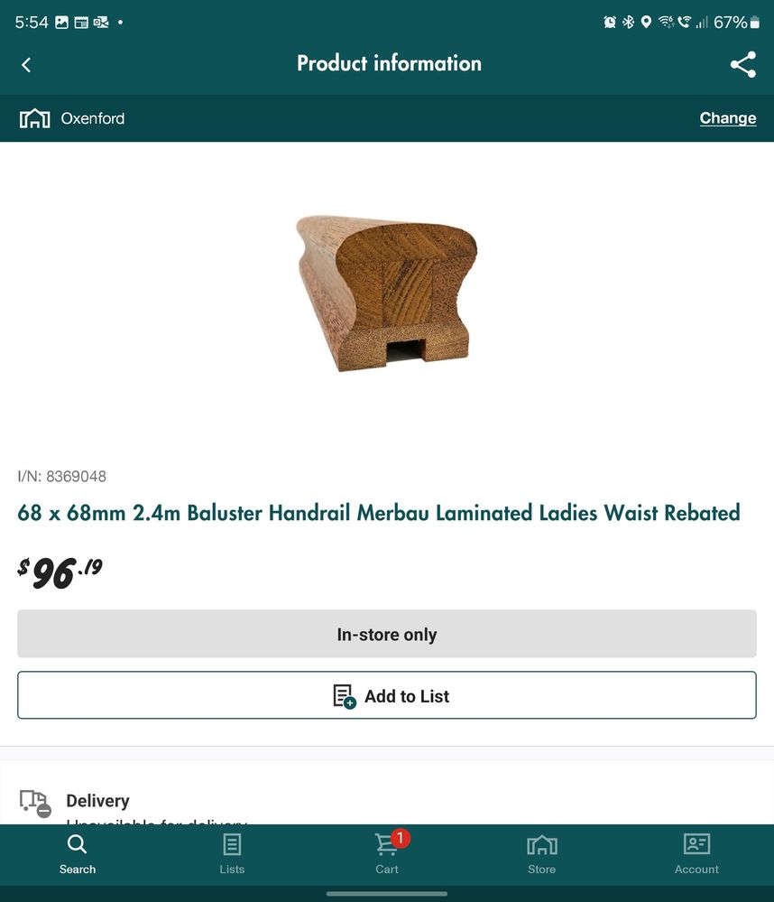

If I use the material below as baluster
How should I fix it to the top and bottom handrail?

Hello @vincehuang
I suggest checking your local council's rules and regulations in regards to handrail and baluster construction. I'm quite sure that they will have the necessary information in regards to the height and spacing of the balusters. In regards to its fixings the balusters should be securely attached to both the stair rail and steps using strong mechanical fixings, such as screws or brackets, to ensure structural stability. Using just glue or nails might not be enough to hold the baluster in place.

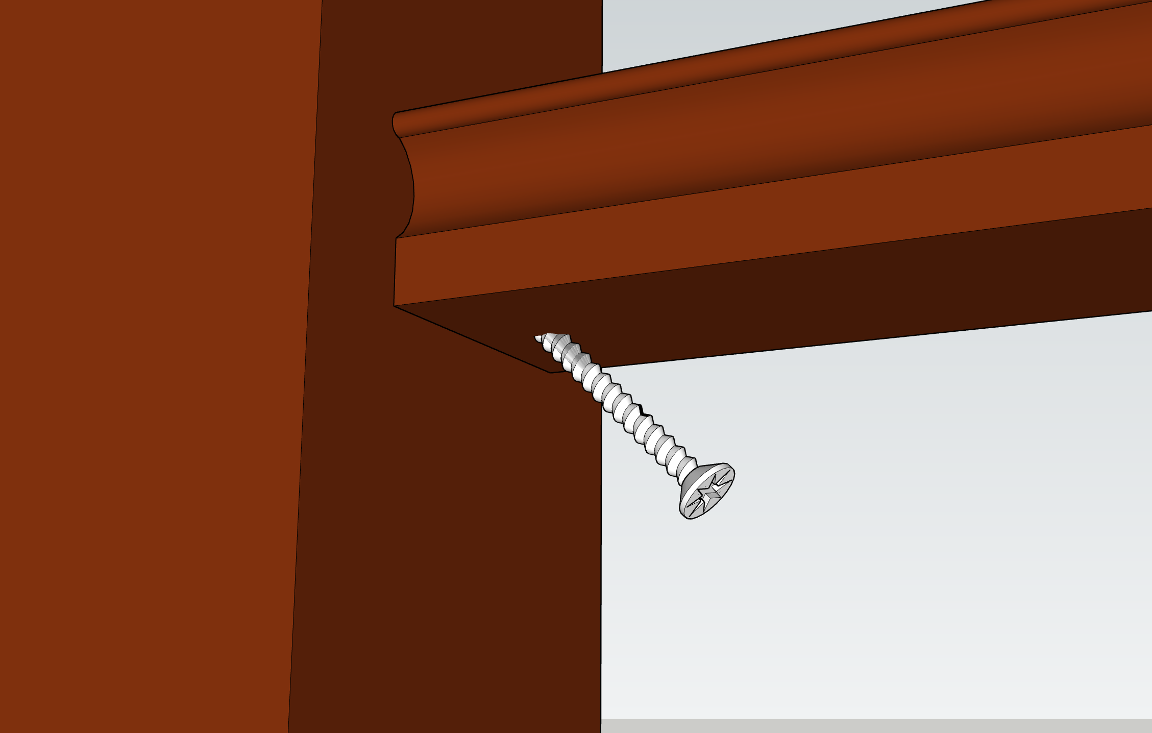

Your solution using Landscape Screws is fine for one handrail but how do you fix the second handrail going from this post to the next?

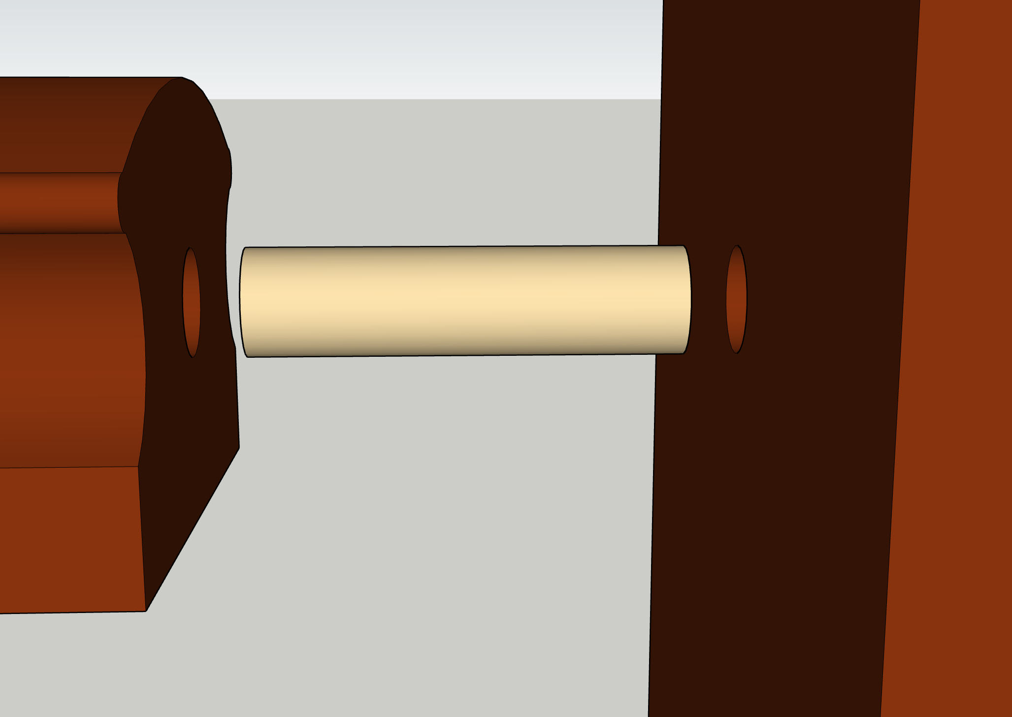

Hi @Carve,
If you have two handrails in line with each other, I'd suggest using dowels and wood glue at the end of each handrail to locate and partially fix the handrail in place.
You can then predrill an angled pilot hole in the underside of the handrail into the post and then drive a timber screw through the handrail and into the post.
The combination of the dowel and the screw will hold the handrail tight and prevent any twisting.
