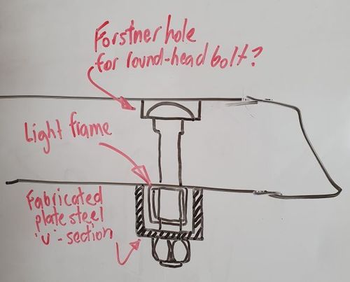

Sorry, one last whiteboard thought and then I will let it rest in your capable hands.
You never said if you wanted the top free of bolt heads?
I was thinking of round-headed bolts from the top, buried - but I think one problem would be that table frame was never intended for the slab and would be made of thin square tube?
Crushing forces to get that slab down - would most likely distort and compress the horizontal tube members.
Hence...
A welded thick plated 'U' section to absorb the forces.
Hope it makes sense.
Cheers.
That does make sense. I'd rather not see bolts.

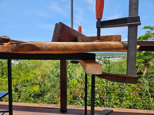

Apologies I'm late to the conversation. My suggested solution is a combination of @Noyade and @Dave-1 and one that I used to straighten a mates spotted gum top that was warping (about 10mm). Like yours, his gets battered by the weather being on a 2nd level alfresco. It too was never secured well to the timber frame underneath. It's almost an exact scenario as yours, but you already have the steel frame that we needed to get made up from another mate who welds.
I have attached some photos below of how I/you could also go about it. Instead of weights allowing time to eventually flatten the top, I used 25mm square tubing across the top that was G-clamped to the steel frame. Then using length of round tubing as leverage to carefully wind in the clamps just a small amount each day. I sourced an old 2nd hand pair that were much bigger than needed for the opening, but had the thicker handle that wouldn't bend as I tightened the clamps.
To help soften the top, I soaked in hot water a couple of beach towels that I wrapped around the end of the top. I then slid over them a large bin liner which contained the heat and moisture. After an hour, I had a go at retightening as any little bit helped. I hand-balled to my mate the daily process of a little bit of tightening - wrapping hot towels - a little bit of tightening. It took about a week to get the board flat to the new metal frame. The top of the frame had pre-drilled holes every 150mm to accomodate galvanised 50mm hex head screws (rubber seal removed).
Hope this helps. Nailbag
That is very helpful. My Dad was a serious steel and wood worker and has proper industrial strength clamps and some heavy duty tubing which I'll have access to in a few weeks.
He also has a steamer that I might add in to the mix.
I'll let everyone know how it goes.

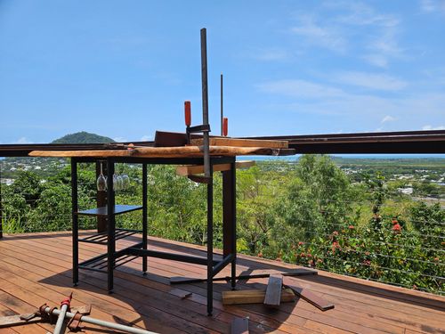

So it's been a while so I thought I'd give you an update.
Warp is slowly coming good. Sides are nearly level after small adjustments daily. I will put in some decent screws and add a couple of brackets.
Then I'll work on the end warp to see if I can get that flat as well.
