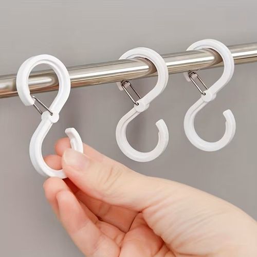

For many years I used S Hooks to hang lights (mainly Xmas) of the two story gutters.
I used to be able to repair or change the lights but with age can't use extension ladder anymore 🙁 so I got a younger family friend to swap with this.
They clip onto the gutter and I use a long pole (with hook) to put up or take down.
That also works well for folks with limited mobility and gutters at normal height (single story).
