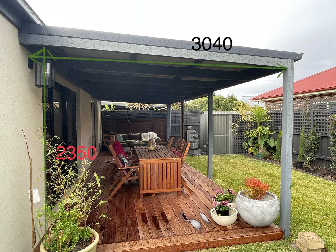

I am planning to prepare my outdoor area to be ready for an upcoming party and make it comfortable for guests to sit outside this season. The right side (when standing in front of my door facing front) is exposed to the North and usually faces wind gusts. The plan is to cover the sides, (and maybe the front 3 sections if needed) to stop the wind and place 1-2 heaters.
Privacy is not the concern but UV is and at the same time I want to maintain the visibility. So please recommend either to go with Bristo Charcoal or Clear?
Measurements:
Right Blind
- The inner right side is 3030mm wide (excluding pole which is 90mm)
- The drop is 2170mm till the deck and 2300 till the grass
Left Blind
- The inside is 3030mm wide (excluding pole which is 90mm)
- The drop is 1950mm till the deck seat (pic 2)
1- What will be the recommended size of the blinds?
2- How do I mount the 210cm Wall Anchors. on the rendered wall?
3- Should I mount the blinds on the outside or inside of patio horizontal frame?
4- As the right side will be most exposed to sun, will the PVC clear get yellowish tint over time?
5- How do I install the blind on left sides as the patio frame finishes before the deck wooden frame. If I mount where the frame ends, blind will drop on the seat. If I install it inside the patio, the blind will drop next to the seat i.e. till the deck.
6- What is the wind rating for this blind? can it handel 60km/h wind gust?

i need more understanding on mounting H3 90x45 timber. I didn’t understand how to use chemset and can i use 70x35 timber?
how about mounting the blind directly on the roof frame? I can tilt a bit to make it straight like this (notice the green line)
if thats possible it will save alot of time and effort
Also there are lot of reviews on edges torn away near the zip side after sometime. Has this problem been resolved?

Hi @DIYImpressions
I definitely believe it's possible to attach the blind to the roof frame of the alfresco. What's important is that the installation be made as level as possible. If you were to install it at a slight angle the bistro blind would come out distorted and out of shape. I suggest looking at the excellent suggestion made by @Noyade to achieve a level horizontal mounting point for the bistro blind.
Using 70x30 is possible, to install it on your rendered wall, you'll need to drill some holes to install Chemset anchor studs in combination with the Ramset 300ml Chemset UltraFix Plus. You'll then need to drill holes in the timber piece and fix it in place using the nuts provided with the set.
I've placed a sample diagram below to give you an idea of how the Chemset Anchor bolts are attached to the wall. The timber piece is then positioned into place once the adhesive cures.
