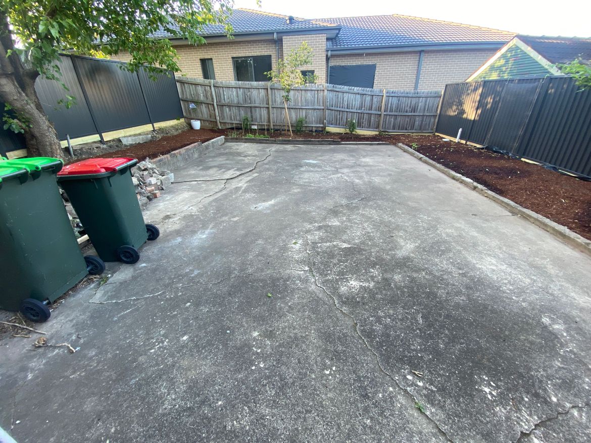

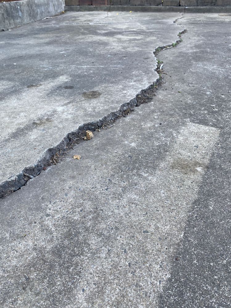

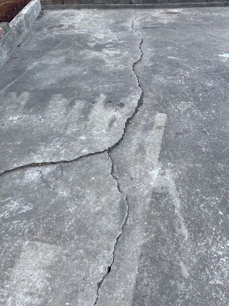

I am thinking of DIY crazy paving an existing patch of concrete in our backyard. My main concern is a large crack that runs through the middle, maybe a tree root or settlement? Not recent. About 20-30mm difference at the highest point. Can I use compacted road base as a substrate above this concrete slab to provide an level even base for the crazy paving?

Crazy paving needs to be anchored to the concrete surface with adhesive, it will not work with compacted road base as the road base is to loose to anchor onto. Instead of using road base, I suggest using Lanko 20kg 173 Floor Leveller or Sikafloor Level 30 (special order product). These floor levellers are rated for outdoor use and can go on between 25mm up to 30mm in thickness.
Before you place the floor leveller on, I suggest giving the surface of the concrete a good clean with 30 Seconds 5L Outdoor Cleaner Concentrate in combination with Oates Long Handle Deck Scrub Brush. If you have access to a power washer, I suggest using it to rinse the surface of your concrete base. Make sure that the surface is totally dry before you use the floor leveller. Please make sure to follow the application instructions so that it anchors correctly to the concrete base.
My best advice is to give the floor leveller enough time to cure before you start paving the surface. Please keep in mind that the floor leveller will level the floor area, but it will not compensate for any future movement.

That area looks quite large, roughly three and a half metres by ten metres, which would make it a very big project for crazy paving. Even when the base is solid, crazy paving takes a lot of time because you need to break the pavers, find pieces that fit together and trim them to shape. A square metre of regular paving might take half an hour to lay, but crazy paving can take up to three hours per square metre once you factor in all the fitting and adhesive work. For a space this size, that would be a huge amount of time and effort.
There’s also the issue of that cracked slab. A 20–30mm height difference suggests the ground has moved or roots are pushing up from below. While you can use a levelling compound to even the surface as Eric mentioned, that won’t prevent more movement in future. If the slab shifts again, cracks will show through the new surface and could cause the paving to lift or break.
