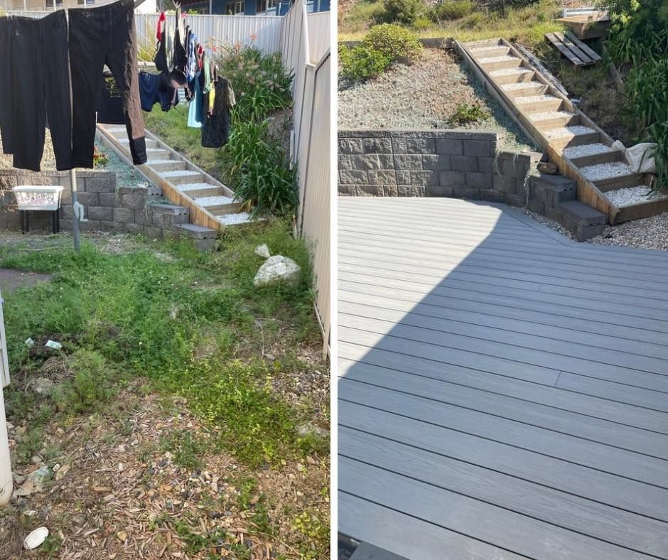

We have recently had an Ekodeck deck installed at the back of our house. This is wonderful but has created a bit of challenge for us in being able to continue using our Hills rotary clothesline. The deck now covers the in-ground socket for our Hills rotary clothesline. When we originally discussed the clothesline options with our landscaper, we realised that if we wanted to use the existing in-ground socket the extra height of the deck above the ground would mean that it would not be a practical or safe height for using the clothesline. It would also mean cutting holes in the Ekodeck which he suggested was not ideal for their longevity. We have a big family and so the wall-based clotheslines don’t cut it, and so we wanted to be able to use our rotary clothesline again.
My wife and I were wanting to create a portable but stable base for our clothesline that wouldn't require damaging our new deck or cutting holes. I had considered adapting an existing outdoor umbrella base, but the tube for the clothesline is approximately 58 mm in diameter, which is too large for these.

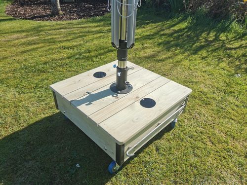

We found this item from Flaming Anvil (https://www.flaminganvil.co.uk/heavy-duty-rotary-clothes-line-base-fully-mobile), but they are UK-based and do not ship to Australia. There are also no other stores in Australia that make anything like this. I would like to create a DIY version along these lines.

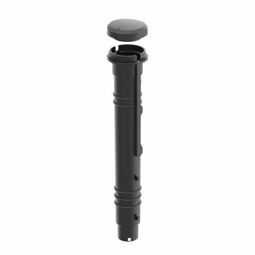

2. If there is no metal socket, then I was thinking about getting another in-ground socket and then build the box around this. This would likely mean that the box would need to be taller (about 600 mm) so I am concerned about how much of an obstacle it would be. I could also just get a PVC pipe or similar instead if it just needs to be able to fit the diameter, but I was leaning this way because they are designed to fit the clothesline exactly.

I can see exactly what you’re thinking with the portable base idea, and it’s clever to try and avoid cutting into your new Ekodeck. But in practice, there are a few big challenges that make this approach tricky. The main issue is stability: a loaded rotary clothesline isn’t just carrying its own weight, it’s holding a spread of wet clothes, which acts like a cantilever. Even a “heavy” umbrella base can’t come close to resisting that sideways load safely. You’d probably need a base weighing 40 kilograms or more, likely filled with concrete, and that’s a lot of weight concentrated on a deck surface that might not handle it well long term. Wheels or castors make it worse, as they focus the weight onto four small points and risk denting or damaging the decking.
The clothesline sockets you’ve looked at, are 600mm long for a reason: the pole needs to be deeply anchored to stay upright under load. A portable base of a practical size simply can’t replicate the stability of a proper in-ground socket. The 600 mm depth is there to give strength. Shorter, mobile solutions just won’t perform the same way.

Any wheeled movable base will tip like crazy with the weight of a wet sheet plus a bit of a breeze is my fear.
I have much the same thoughts as the two wise men above @chriskeipert
I made a 40kg mobile steel base for an umbrella - but in a strong wind, over she goes.
I thought of a larger base - but it all becomes counter productive - you want it to move, but now it's too heavy.

PVC Pipe-
I have responded to questions here such as larger umbrellas, retractable clotheslines, solar inverter sun protection, removable shade sails, fencing & screening etc. often when people are renting.
Select a best fit PVC pipe size.
Dig the 'post hole' depth so the pipe top is just below ground level PLUS about another 100mm for gravel.
You want to achieve a result where the PVC top is just below the surface with the pipe tampered down into the gravel.
Improvise a removable plug and paint it green or stick-on artificial grass.
