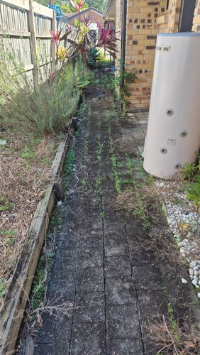

Our side of the house is something we never see. It's an area we never go outside.
The neighbours kids have knocked down the fence so we thought it's a good chance to redo the back as we get a new fence.
The plan would be to dig up the pavers & garden bed and replace it with gravel. There is at least one black drain down the side. In 2022 when we had torrential rain for days it would build up water so I'm not sure how useful the drain is. We get all the neighbours water (bottom of the hill).
Is this a DIY job? Digging out the pavers/garden beds and just replacing it with gravel (maybe a paver... But we literally don't use this space at all).

Simply digging out the pavers and garden beds and replacing it with gravel would absolutely be achievable as a D.I.Y. job, however you might like to take the opportunity to have a plumber install some additional drainage that is plumbed to a stormwater outlet to help mitigate the water issues you've faced in the past. Another thing to consider is the logistics of removing the pavers, garden bed materials and mulch. If you have a ute, or a trailer this is certainly manageable, but a mobile skip might be a good option for you.

If you'd like to keep it simple, once the pavers and garden bed are removed, the side yard is tidied up, and any drainage has been installed you could simply cover the space with drainage gravel, which can often be ordered in bulk. You could also install some stepped pavers to maintain some utility for the side yard.

Q1 Do you use the side path for anything, lawnmower, garbage bins?
Q2 That black drain drain you mention, is it an ag styled pipe? or is it a grill for a drain?
I definently would consider installing some new stormwater piping to the street (If it dosnt exist, If it does then a plumber to clean them out with their water jets) with a couple of pits down the side of the house, The pathway depending on how often you use it Id leave it and just water blast it to clean it. The garden bed I would probarly level, remove the weeds and then weedmat and maybe white pebbles over it to around 6cm in depth at least to help stop weeds
I can see a downpipe just beyond the side door so you do have a stormwater pipe there. Maybe get a plumber to give you a recomendation on including a pit or two and connecting it in? Depending on what state you live in there are some different rulings to that. Your local plumber will know what they are.

Are you just going to gravel? Keep in mind gravel can be a pain to keep fresh, and is a great place for weeds to grow. So it can be frustrating to maintain. Depending on the placement I would also keep in mind gravel can create a heat sink.
If this was my space I would consider keeping the garden bed and refreshing it with low maintenance plants. I would also add stepping stones and a low maintenance ground cover such as native violet or dichondra (these can keep the weeds at bay).
