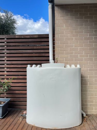

My end goal is to remove my rainwater tank. The tank itself looks easy enough and I believe I can manage that on my own so my question does not have anything to do with the tank.
The tricky bit is redirecting the rainwater pipe into the rainwater drain and that is my main question today.

How do I redirect the rainwater pipe away from the rainwater tank and into the rainwater drain?
Here are the steps I think are needed to redirect the rainwater pipe:
1. Cut off the existing pipe joint leading into the watertank
2. Purchase the required pipes and pipe joint
3. Place the new pipe joint and pipe to direct the water into the drain
4. Glue the pipe joint and pipes using the purple and clear stuff (not sure what they are exactly yet but I have seen them on YouTube videos)
