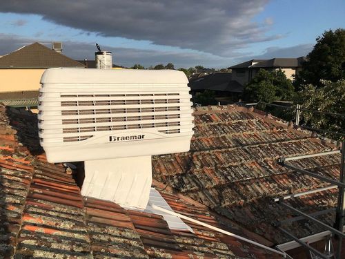

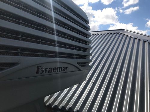

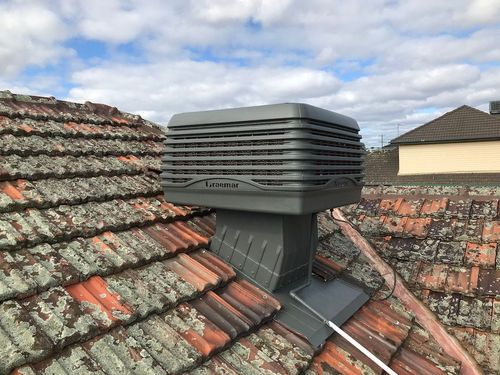

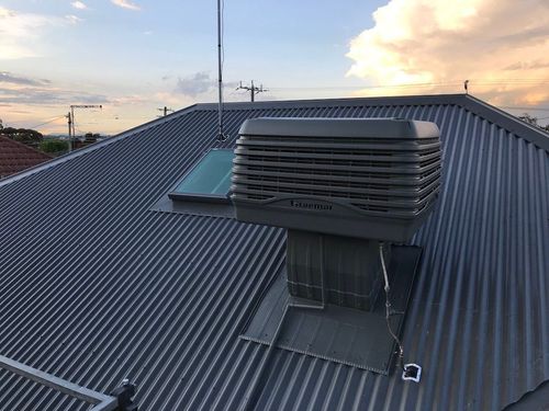

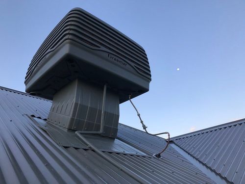

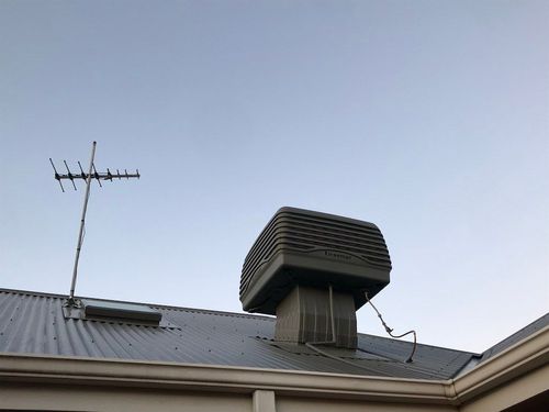

Process:
  • Sugar soaped the unit twice allowing it to dry between each wash
  • Applied Taubmans 3-in-1 prep interior/exterior undercoat. The tin was 2L - probably uses 50-60% on 2 coats across 2 days
  • Applied Dulux Weathershield Low Sheen in Woodland Grey. The tin was 4L - Applied 2 coats before the new roof went on
  • Applied a further 1-2 coats of the Dulux post roof completion (the roofers used the aircon a lot for boxes of bolts and generally holding on etc) - this meant that a few scrapes and chips were appearing. In total used about 50-60% of the paint.
Project undertaken October 2020 - will provide an update if I start to see the paint flaking or any obvious signs of weather-wear
I probably spent 2 hours per coat. I only used 50% of the paint vols.
So far - I'm super happy with the outcome and from a few metres away on the ground you can't see any imperfections! :smile:
