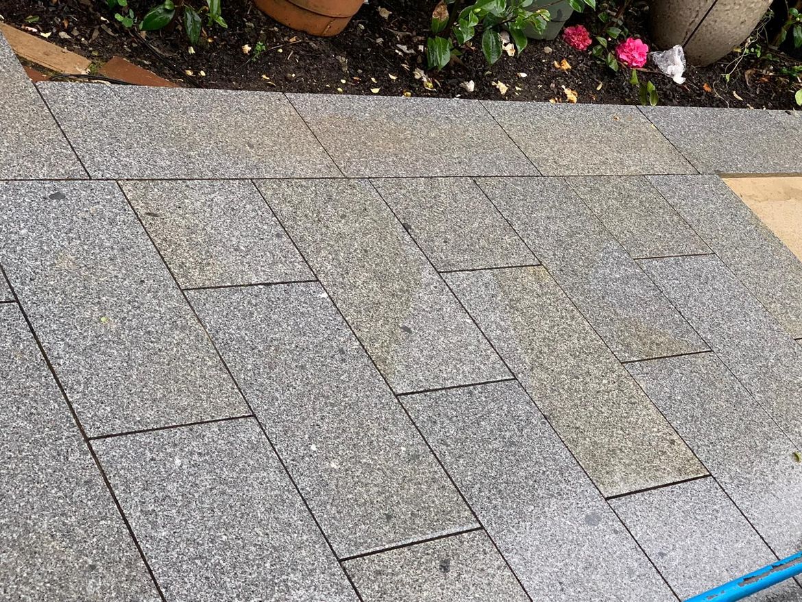

We are currently installing Silver Grey Pavers outdoors in our backyard. Some of the pavers have yellow marks and some have balck blobs. Can these be removed or can they be hidden by tinting the pavers?

Are these new pavers that you are installing? I'm asking because you might be able to conceal or remove the staining, however, I would be concerned if these are how you purchased them. That appears to be some type of ferrous metal induced rust staining or potentially due to tannins leeching onto the tiles. In both cases, you can only really try products like CLR for rust stains or an acid wash for other stain types.
The main issue that arises with removing this type of staining is where it is located. If it is just a surface stain it can be easily removed but if it has penetrated deeper it can be difficult or impossible to remove.

Hi Mitchell
These are just purchased. Is it normal for this colour pavers to come with these stains?

In my limited experience of paving I would say that is not normal. Were they 2nds?

As @Brad has mentioned I would agree that the degree of staining is not normal. I would be looking to exchange the stained pavers for ones that do not have the issue. If you purchased these from Bunnings I would be more than happy to assist you with the exchange process.

Hi @sat No. Absolutely not normal. @MitchellMc nailed it, they look to have been stained while stored & it looks like tannins from hardwood or rust/iron stains.Pavers such as that should be a consistent colour (allowing for 'natural' variations).I'd be having a chat with your supplier because if you are positive it hasn't happened at your end & they were supposed to be 1st, not 2nds quality as @Brad mentioned, then they should be remedying the problem.

I mentioned it would be worth trying CLR for rust stains or an acid wash to remove tannins. Do the pavers have a black grout around them? You might want to try and keep those products off the grout as they could discolour it.

Will have a go with CLR and acid wash.

We are currently requesting in the first instance the pavers are replaced and then for the balance if any we will try your recomended products
