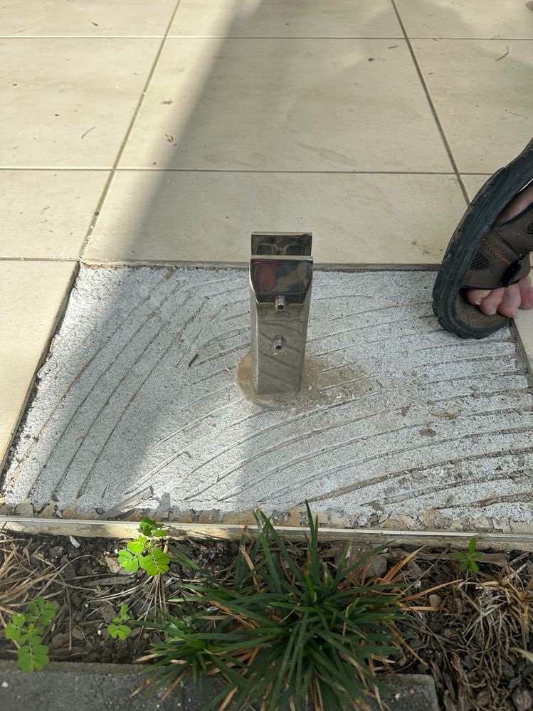

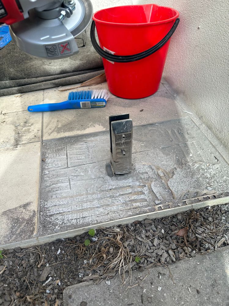

We have had pool fence repositioned and now we need to remove posts that have been very securily concreted in! My husband is trying to do this with a grinder - but its going to take forever to cut it then grind it down level so that we can place a tile over the top.  Any other suggestions?IMG-3150.jpgIMG-3151.jpg

I'd suggest sticking with the grinder. It will take some time, but it shouldn't take that long. The only other alternative I can think of would be to try and break the concrete, but that would likely also be a rather tedious exercise. Let me know if you're not making any headway at all with the grinder, and we can try and find another solution.

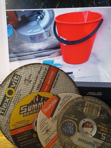

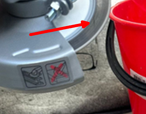

Could be just my eyes or an optical illusion - but it looks like in your photo - the angle grinder is on with the blade spinning?
And through that spinning blade I swear I can see the right arm of the spectacles in the background on the ground - through the blurring blade?
Illusion?Illusion?

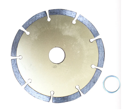

You aren't using a diamond blade to cut the steel - are you?
If not - what blade are you using? I'm with Mitchell here - you should be making short work of this.
