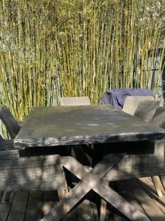

we have a large outdoor table that is cracking only on the sides of the tables
we would love to repair so nothing else cracks away so we can continue to use
not to upset if it doesn't look pretty but at least if it is functional
any suggestions would be appreciated
see photos

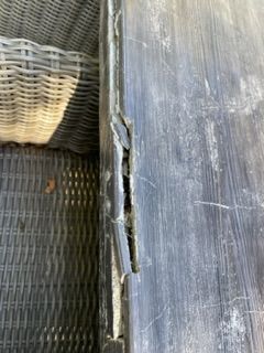

Thanks for sharing your question about your concrete table. Looking at the photos you posted it seems like the cement substrate material has deteriorated badly. If the deterioration has started on the sides, it's likely that the rest of the material has become brittle due to long term exposure to the sun. Using glues or putty will be a short-term solution and whatever you fix in place will break off as the tabletop is already brittle.
Does your table have a timber frame underneath? If it does, I suggest having a look at this featured discussion - Outdoor table using Merbau fence panels by @daniel4. This is an excellent method of replacing your existing tabletop with a timber one. Because it is made of Merbau it can used outside of the house.
Let me call on our experienced members @Dave-1 and @TedBear for their recommendations.

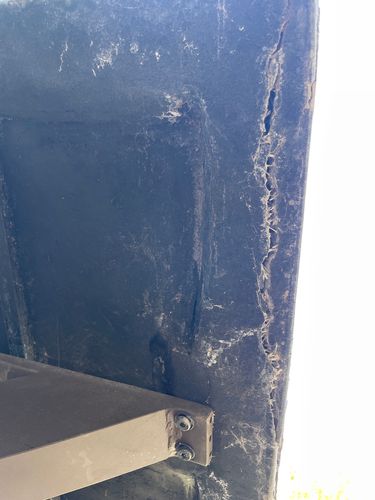

Bugger! Any chance of a larger photo of the underside of the table? I am wondering how thick the actual concrete is or if its a coating of some kind?
Just looking at those pictures it looks like its the edge that is coming away, tends to make me think its a coating more then one whole slab.
One idea while we wait for the underside pic :smile: is you could potentially put a new edge around the table? Just using timber with some angled cuts for the corners. Attaching it would depend on what the thickness of the table is made up of.

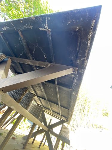

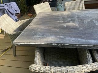

Thanks for posting those extra photos of your table. By the looks of it, the tabletop is beginning to fracture as seen from the large giant fissures forming in the middle of the table. It looks like part of the table is made of steel, but the sides of the table are beginning to crack as well.
The good news is that your table legs are still intact and in good condition. I propose upgrading your tabletop to a timber one rather than trying to patch the old one.

😕 Thanks for the photos. It really looks like the cracks extend further then the edge. It looks like a composite type deal with the metal frame used to support the concrete coating. Id side with @EricL's suggestion that it is time for a new tabletop 😕 As those cracks on the underside are in the middle of the table and I can imagine a nice evening meal heading South very easily 😕 I think if you tried to repair the edging it would fail again within a very short time frame due to teh naturue of its construction.
If your remove the top half concrete/half steel support of the table those legs are really nice. Anything from the merabu timber top mentioned above to even a compressed concrete sheeting style would be doable. james hardie 1800 x 900 x 19mm secura interior flooring (I like the concrete style :smile: )
