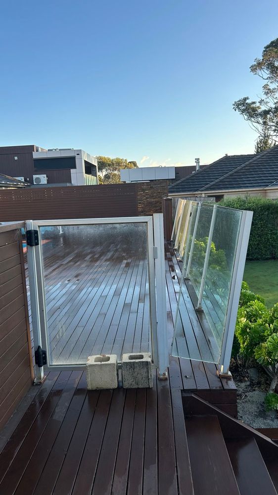

Last night the wind was horrible at Melbourne. When I woke up this morning, I saw our glass fence was damaged.
Right now it is not only slant, but sways with wind.
As you could see from the picture, one side used to be connected to the small glass door, but now is splitting. The worst part is, the other side of this glass fence is not connected to the wood wall. I think that might be the main cause of this unstable situation.
Therefore, dear community, I am here seeking for help.
1)How do I repair it?
2) How do I prevent it from swaying with wind?

Given the nature of this task, I recommend hiring a professional pool fence installation company. In the meantime, especially if you have children or pets, secure the area to prevent access. The fence panels are quite heavy and could cause serious injury or even be fatal if they fall on someone. It's important not to risk anyone's safety by attempting a DIY repair.
The pool fencing company will need to carefully disassemble the fence, and it's important to discuss with them why this issue occurred. I suspect you'll also need to have the timber frame inspected to ensure it’s suitable for the installation.
Once the deck frame has been inspected, you'll be able to have the fencing company re-install the fence if it has not been damaged.

As per Mitchell's advice - but I'm fascinated as to how this has occurred. At first I thought the post attachment points on that one strip of decking have been levered to the right - but I don't think so? To me the entire right hand side of your decking has collapsed at the angle indicated below.
Any chance of photos - below the deck at the ground level?
