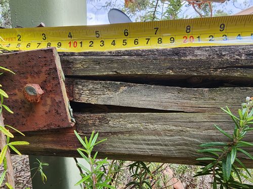

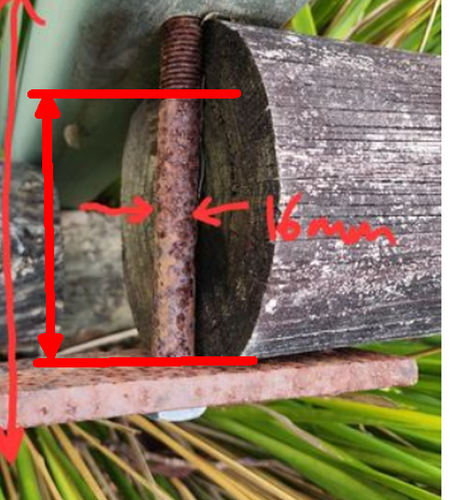

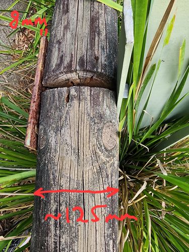

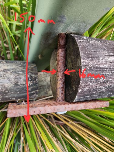

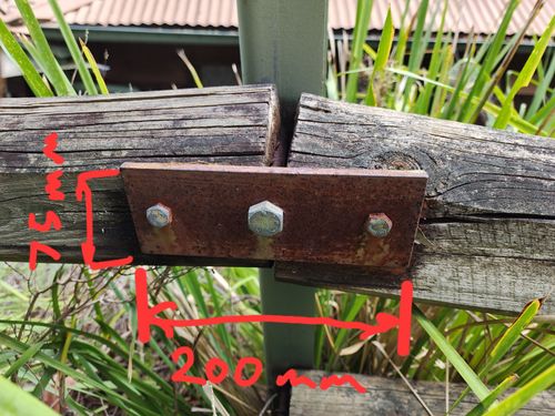

I have an old fence/barrier made of treated pine logs bolted to plates and these are bolted to very large metal posts/girders. The plates and bolts are rusted through and the pine logs are splitting. I can't find any replacement plates nor brackets. How should I attack this?

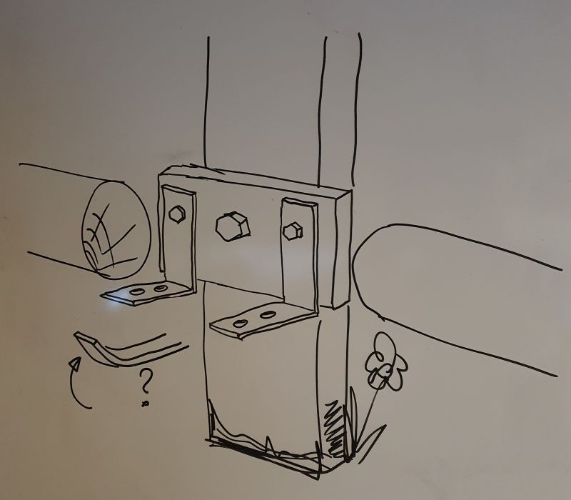

You would probably need to modify the bracket in order for it to work. Especially if you used a large bracket such as the Dunnings 100 x 100 x 35mm M10 Galvanised Angle Bracket. The holes would need to be enlarged and relocated so that it supports the posts properly.

You could possibly utilise the same steel plates and bolts you already have - bring it to the post with the brackets mentioned above mounted to support the posts. Possibly bending the lips for a better fit around the logs. But that plate is thick - you mentioned 8mm on the previous page. I'd be using a drill press.
Just a thought.
EDIT ; Just realised! You already have the holes! 😁 Via the coach screws.
No need for a drill press.

However, be aware @MSSM - that looking at your second photo from the bottom, it's most likely when you place the plate and bolt hard against the post - there will be no thread for your nut on the other side. You'll probably need shorter bolts. Hard to tell from this side of the monitor.

When you say "rusted through" are there others that are in worse state then the brackets you have shown? These look like they could be removed, cleaned and rust converted back to be used  again if you wanted.
The state the rails are in look like they are at the end of their useful life as rails. You could also bolt (using the holes for the rails) a vertical piece of timber to the metal post that may give you more freedom in what rails you could use? And Just had a thought that depending on what type of rails you need, would a wire fence work? That way the vertical timber posts attached to the metal backing would work.

Yes, I've already been advised that there's nothing really wrong with the plates.
It's just the logs and bolts that are the problem.
I want to keep it looking the same.
