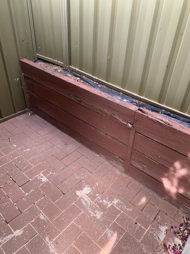

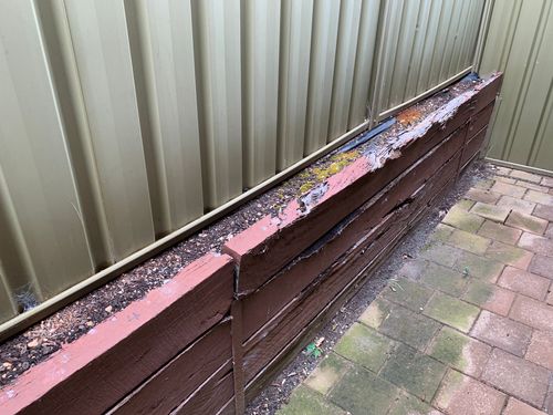

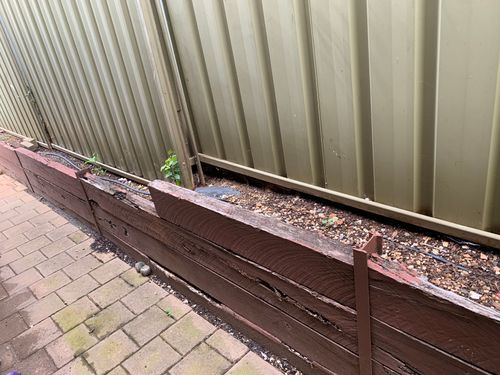

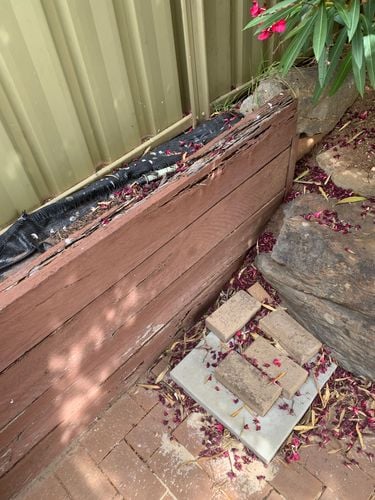

Thank you all for your feedback. A few more images to look at. It looks like it will be a big job for me but willing to give it a go. The cement sleepers will be 2,000 length x 200 height x 80 width

You must be superman! lol Man those sleepers will be on the heavy side! Now that I can see the fence posts you have me thinking of replacing the actual timber rails with tiimber, They are U chanels so could stay in situ and you cut the new timber to length? Unless you are set on the concrete style. Whichever way I would also suggest to put in drainage at the bottom of the retianing wall, It will help prolong the new wall.

It's great that you've received excellent advice from our members. It's a challenging undertaking, but if you do it one section at a time, you'll be able to approximate how long the project will take. Looking at the pictures you posted it seems that the brick flooring was placed after the retaining wall.
It will be necessary to factor in the disassembly of the brick floor to your jobs list. My best advice is to call either your local council or Before You Dig to make sure there are no local services running under the new spot where you'll be putting your posts in.
