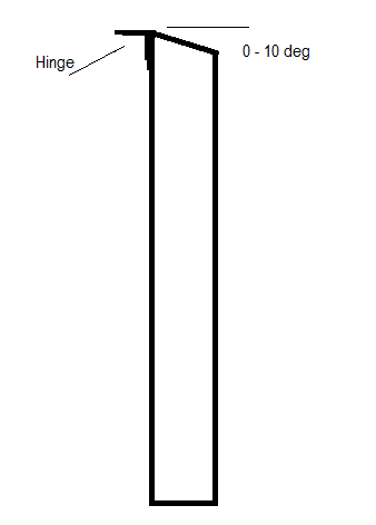

Re folding table, you could install card table folding stays. Another easy option is to cut the top of the leg horizontal support at approx 5 to 10 degree angle, this would allow the table legs to open out a bit further than the width of the table, you could do this by using a hand plane. (see sketch below)

Hi @jennyxn , I see that you have 3 suggestions, all of which will work.
However, given your criteria contains the words inconspicuous and minimalistic, I think you then don't have much choice but to use @JoeAzza 's first suggestion to reshape the top of the leg cross-pieces from their current square top to a slight angle, such that the legs over-extend a little beyond the upright position. They will then tend to spread outwards (they can't go far, just a few degrees) instead of falling back inwards. (Their weight hanging on the outside of the hinge pin is naturally swinging them inward).
I recommend that you also plane the bottom of the legs parallel with the new top angle so the bottoms will sit flat on the floor when in position and therefore be even more stable.

hi @JoeAzza, thanks for the great ideas! I think cutting the top would be the best option for me as I don't really nice to add anything more to it.

Hi @TedBear, thanks for the tip! I will try to plane both top and bottom
