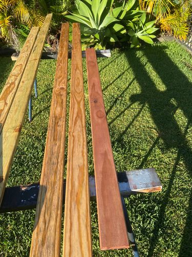

I recently purchased some new treated pine decking from Bunnings. I have noticed that half the batch is a white colour and half a green colour. I also purchased a Feast and Watson stain Swan River Jarrah. I tested the stain I both board colours and they are completely different. My question is, will the green coloured board eventually turn the same colour as the white coloured board so I can get some consistency with the stain colouring.

Pine is a natural product that often behaves differently when treated with preservatives. Discolouration sometimes happens, I propose cleaning the timber deck with Cabot's 1L Deck Clean. However, I strongly recommend testing an off-cut or independent piece before committing the whole deck.

Hi @daveom,
It appears that you've ended up with products from two different batches. As my colleague has mentioned, this could be due to different reactions to the treatment or different treatments. Our range of treated Pine decking is either ACQ or LOSP treated. These treatments are excellent and have the same purpose but can have distinct colour variations. I would recommend returning the product and picking up lengths all from the same batch and pack. If these lengths were all from the same pack, I'd be happy to contact the store for you to ensure our team members assist in locating similar stock.

Hi Mitchell, Thanks for replying.  Unfortunately before I realised that the decking was two different colours I cut them to size. It was only when I test coloured the boards that I realised that they were probably from two different batches.  Not sure now what recourse I have.
