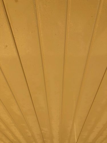

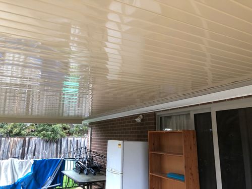

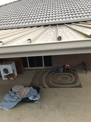

Thanks for the response. The problem occurs mainly in the mornings. I’m not sure how to go about installing any product as it is a single sheet. I’ve included some photos. Your advice and help is appreciated

Thanks for the images, @condruss.
OK, that's a bit different. I presumed there would be some structural elements (rafters) supporting a roof over that distance. Since this isn't sheeting on rafters, it negates my previous suggestion.
If it is a single sheet, it limits your ability to fix anything to it as well. You couldn't really baton out the roof and install sarking or fibre cement sheeting, as the screws would penetrate the roofing sheets, leading to all sorts of headaches.
