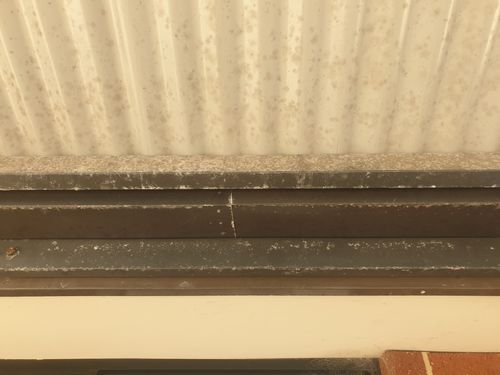

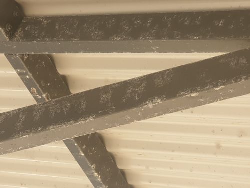

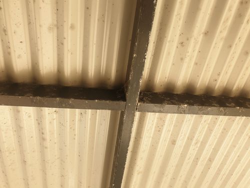

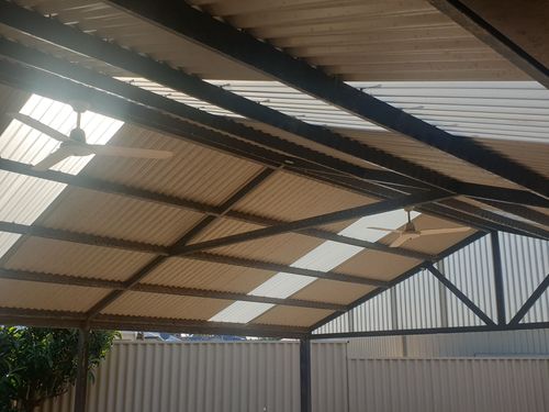

Hello. I’m after some advice. I have an outdoor metal patio with single sheet metal roof. We would like to enclose a section with a room and the other area with half colour bond and drop down screens. The problem we have is build up of condensation water droplets on roof underside. How can we stop this happening? What products could we use? The patio size is 10x3.5 on a concrete slab. Thanks Shane
