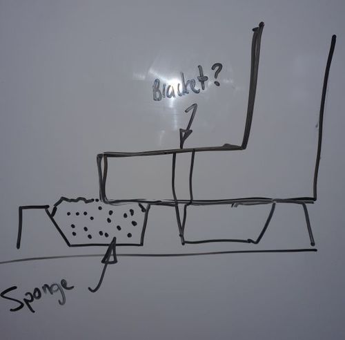

I watched your video a few times but can't figure out what the exact cause is. Is it the dripping distance from the downpipe end to the corrugated iron?
Would a sponge shoved under the tip eliminate the noise? Not so much as a permanent solution - but a process of trial and error. See what works.

Just to add my input, what I think is happening is that the drips from the downpipe are dropping down and hitting the hard right-angle corner at the bottom of the downpipe. This wouldn't normally create such a loud sound, so I suspect that the noise is reverberating through the trim piece that the corner is on and amplifying the sound. I think replacing the right-angle corner with an angled one and elevating it above the trim would dramatically lessen the sound and probably resolve the issue.
