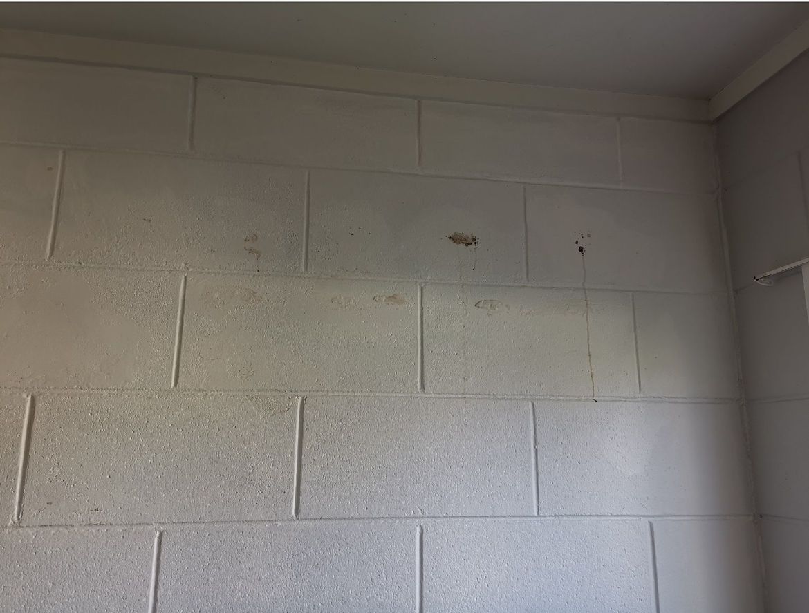

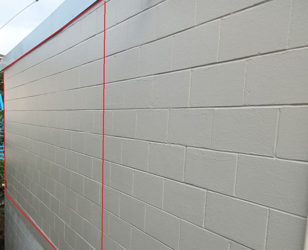

I have a bedroom interior wall showing marks of water ingress. No issue from the ground as the unit is on 1st floor. The unit was built in the late 60'. Please see attached images.The red line boundary marks the exterior wall of the affected bedroom wallThe red line boundary marks the exterior wall of the affected bedroom wallAffected interior bedroom wallAffected interior bedroom wall
Early this year, the exterior wall was painted with zinsser watertite. It helped to block water ingress on most part of the wall but there were some small marks appearing on the wall after a rainy day.

Does the issue only occur during rain events? Are the watermarks inside predominantly at the top of the wall?

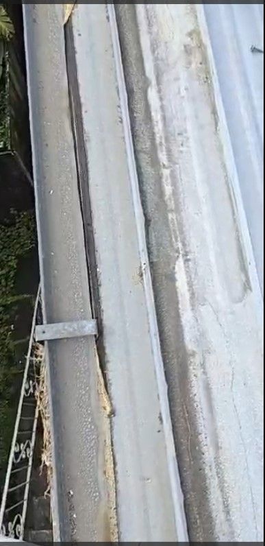

Considering the history you've mentioned, the issue may be coming from the new flashing. If water can find a way underneath the flashing, it could certainly find its way inside.

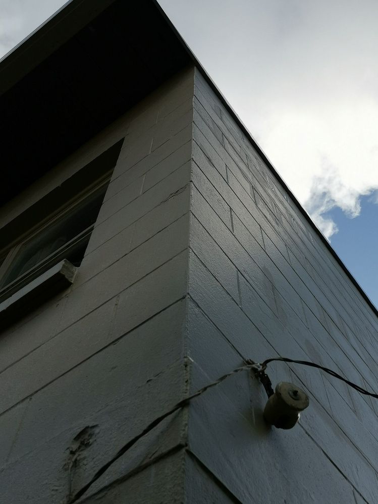

It looks like the flashing may have a mitred corner at the far end of your first photo. If the corner of the flashing wasn't well sealed, water could find a way under it and in turn track down the wall.  Is it possible to get a photo of this?

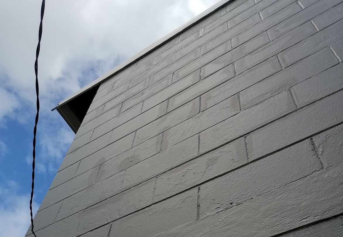

It is interesting that in some spots where the water is leaking through, there are brown stain marks. I am wondering if this is from water which has been running down and through timber and into the bricks. There are no such marks on the outside, so the water is likely to be getting into the bricks from above.
Since it is a single block wall there are no metal ties that would account for the brown stains.
This part of the wall appears to be at the lower part of the roof slope, so perhaps the water ingress is starting from the higher end of the wall and running along the top of the blocks before saturation and leak through is occurring up there ??

I notice the issue occur during rain events. Yes, I would say the watermarks are predominantly near the top of the wall.

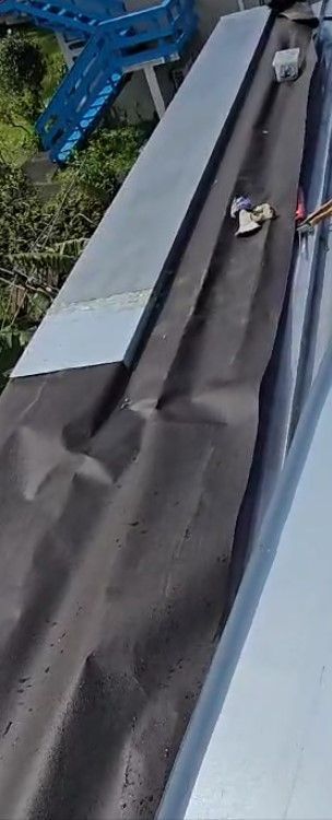

I trust the builder did a good job to secure the flashing from any leak. Please find attached photo for the flashing work. Do you think I should get another builder to verify there is no leak from the flashing?
flashing to bottom endflashing to bottom endflashing from top endflashing from top endbefore workbefore work
Here are the photos of the far end from the ground.floorview2.jpgfloorview1.jpg

Thanks @Dave-1  for your help and suggestion. I have attached a few photos of the flashing work done by a builder. Do you think that getting another builder to check if the water still leak ?
