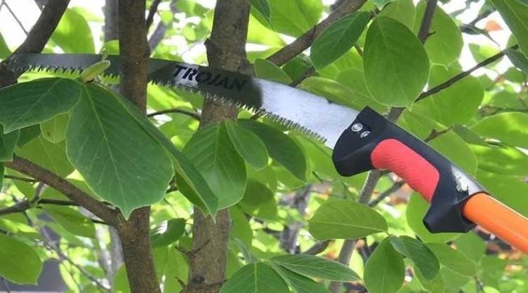

A standard pruning saw such as the Trojan Carbon Steel Pruning Saw has a hole at the back of the handle. On the condition that the pole is compatible with the size of the hole of the handle you can secure it by drilling into the pole and attaching the bolt and butterfly nut provided.

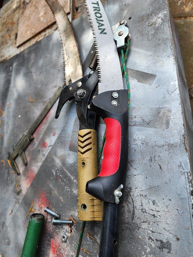

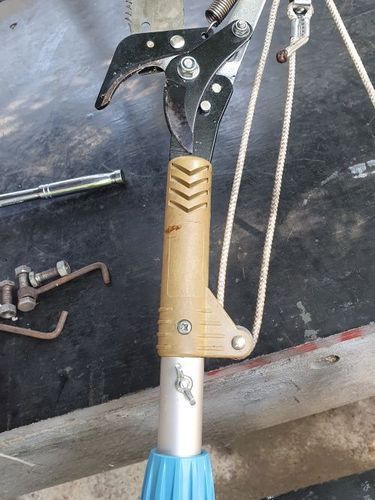

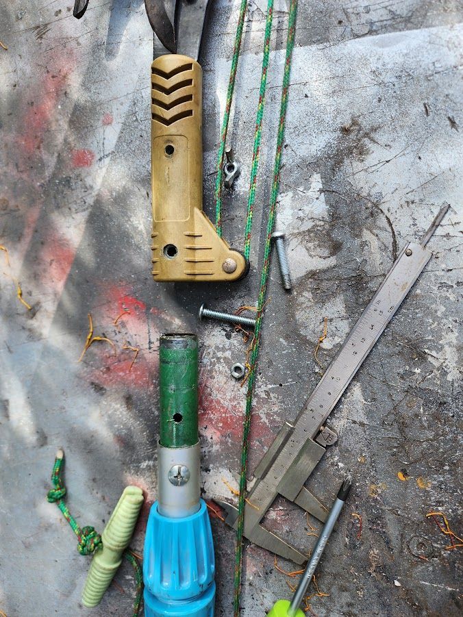

I made two types.
The Trojan which @EricL has shown above - has a 25 mm internal diameter - fits any 25 mm pipe and I made it a long non-telescoping type.
Little trickier with the telescoping pool-pole. The aluminium tube needs a 25mm pipe insert to accommodate the 25 mm head.
Hope that makes sense.
