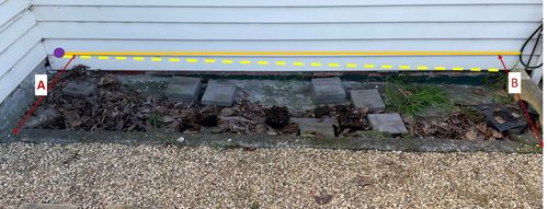

I’m thinking of building a wooden deck over this sunken concrete area. But I’m confused with two issues - what ‘level’ to use and if/how I should adjust for the uneven shaped area. See pic below
Level
I’m confused because to make the deck horizontally level/flat, I would build it roughly along the solid yellow line in the picture. But this would mean the deck would get higher and higher compared to the slope of the concrete wall (by about 15cm by the end of the deck). Which I think would look weird. Alternatively see the dotted yellow line if I followed the slope of the concrete wall. Obviously the deck would not be flat if I followed the dotted line. But this may not be a problem as the deck would rarely be walked upon - this sunken area sits near the front door and hardly ever has anyone walking in it. I’m just hoping to clean it up to make it look nicer. Any thoughts on what to do?!
Size
The distance from the concrete wall to the house on one side (Distance A in the pic) is about 97cm, while distance B is about 93cm. So the area gets smaller by about 4cm. Would I just line up the decking board to the concrete wall at the front, and then cut the last decking board near house to size? Cut this final board like a wedge?
