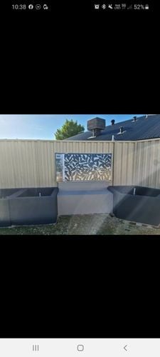

Hello,
I'd like to install my 1.8mtr plastic matrix decor panels ( x4) directly onto my colourbond fence. They will be place in the middle of the sheets so im worried the screws will be pointing straight through onto neighbours side of the fence.
What can I use to secure them onto the fence without having screws pointing through behind the colourbond sheet?
*note: I cant put posts in nor fix them to the fence posts.
Thank you

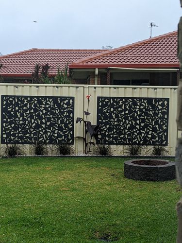

You are correct that the screws will pierce through to the opposite side of the fence if you drill directly into the Colorbond panel. Are the Matrix panels butting up next to each other in a continuous run? If so, you might like to read through this previous discussion: How to install a Matrix Decor Screen to a Colorbond Fence by @firenevac. Within it, I describe how to fix a timber cross member between the posts and screwing the panels into it. In your case, you would fix the two timber cross members in the middle of the Colorbond fence to support the top and bottom of the Matrix panels.

I agree with Mitchell's solution... the only other variation I can come up with (other than undesired support posts) is to insert some vertical timber (or metal) in the concave (from your side) sections of the metal panels. There would need to be separate top and bottom uprights so you can get them into the rails. Trim the ends down if need be, so they tuck  in behind the lips of upper & lower rails.  (Attach the bottom legs, stand the  unit in the channel, then attach the top ones to stop it falling out.) If you don't wish to put any holes in the fencing, then you wouldn't need to, since screwing them to the matrix would keep the strips upright and in place.  You could paint them the same colour as the fence so that they would blend in behind the matrix.  I hope that makes sense.
