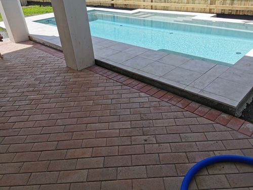

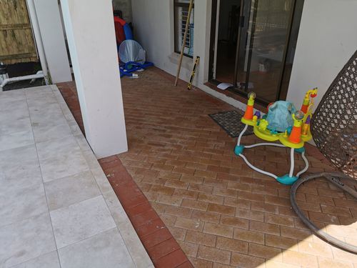

g'day guys, new here and after a bit of advice. I'm in the process of planning a small deck build between a pool I've just had installed and my back door (roughly 2m). the problem is I only have 90mm clearance from concrete to the top of pool tile and and wanting it at the same level. my plan was to have a ledger against pool and one underneath the door and run joists between but can't find a suitable joist hanger for the size of timber I need that won't wear out as it's near the pool. after any tips or advice thanks in advance

i think the photos have been uploaded. the deck is going between the house and the pool as shown
Re: low level deck near pool.
Hello @ponga3
Thank you for posting the photos of the area. A good place to start would be to have a look at this guide: How to build a low-level deck by @Adam_W. I'm afraid building the deck at the 90mm height you require is not going to be viable. If you only have 90mm and take away, for example, 70mm for the smallest timber frame, less the thickness of the Merbau decking panel leaves you a 1mm gap between your brick floor and the decking frame. It becomes even more concerning because it is next to the swimming pool and if that water gets stuck under the frame of your deck it will greatly shorten the life of your deck.
A possible solution is to remove the bricks that are currently there. If for example the bricks are removed, you would possibly gain approximately an extra 60mm of space, add your 90mm and you have 150mm of workable space. You can now use a 90 x 90 H4 treated pine post near the pool. It's a bit overkill, but the post is treated for severe wetting. You can then use Ekodeck so that it will be impervious to your swimming pool water. Using this set up you would have 37mm left as an air gap under the deck.
