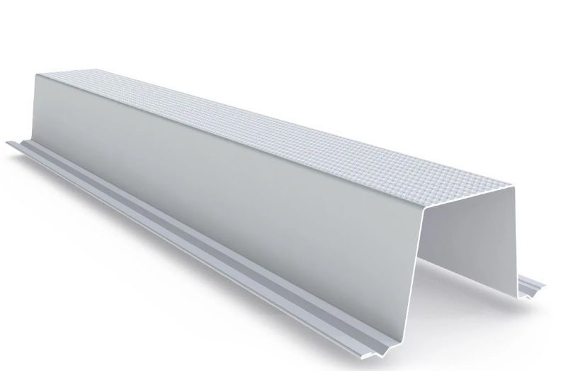

One of the carpenters maintenance guys from my work suggested I use galvanised roofing battens for installing deck with minimal clearance to concrete.
He said he has done this many times and secures the roof battens (see stock pic for example) by drilling through edge of batten to concrete and using galvanised screws with wall plugs at 300mm - 400mm spacings between screws.
He levels the battens by using galvanised washers underneath when screwing down if needed
https://www.bunnings.com.au/ramset-8-x-50mm-blue-wall-plugs-blue-pack-of-25_p2260643
