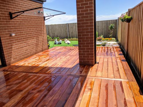

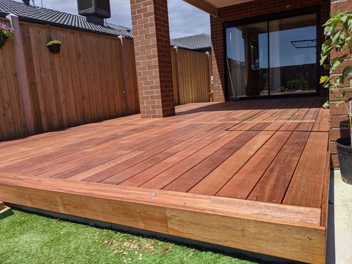

Finally the deck is ready!!! It took 3 full weekends to complete it. Can't be more happier with the outcome. Now on to oiling part.
Question: Do I need to weather the deck or use Intergrain UltraPrep Tannin And Oil Remover and the deck clean & apply the oil straight away? My son's birthday is coming and I am hoping to have a little party there.

That looks amazing! You should be very proud of your efforts.
For a new deck, you'll need to use the Intergrain UltraPrep Tannin And Oil Remover and once you have completed that process you then use Intergrain timber cleaner. After the two products have been used to their specifications you can coat the deck once it has dried.
Congratulations on your result and please let me know if you have further questions.
