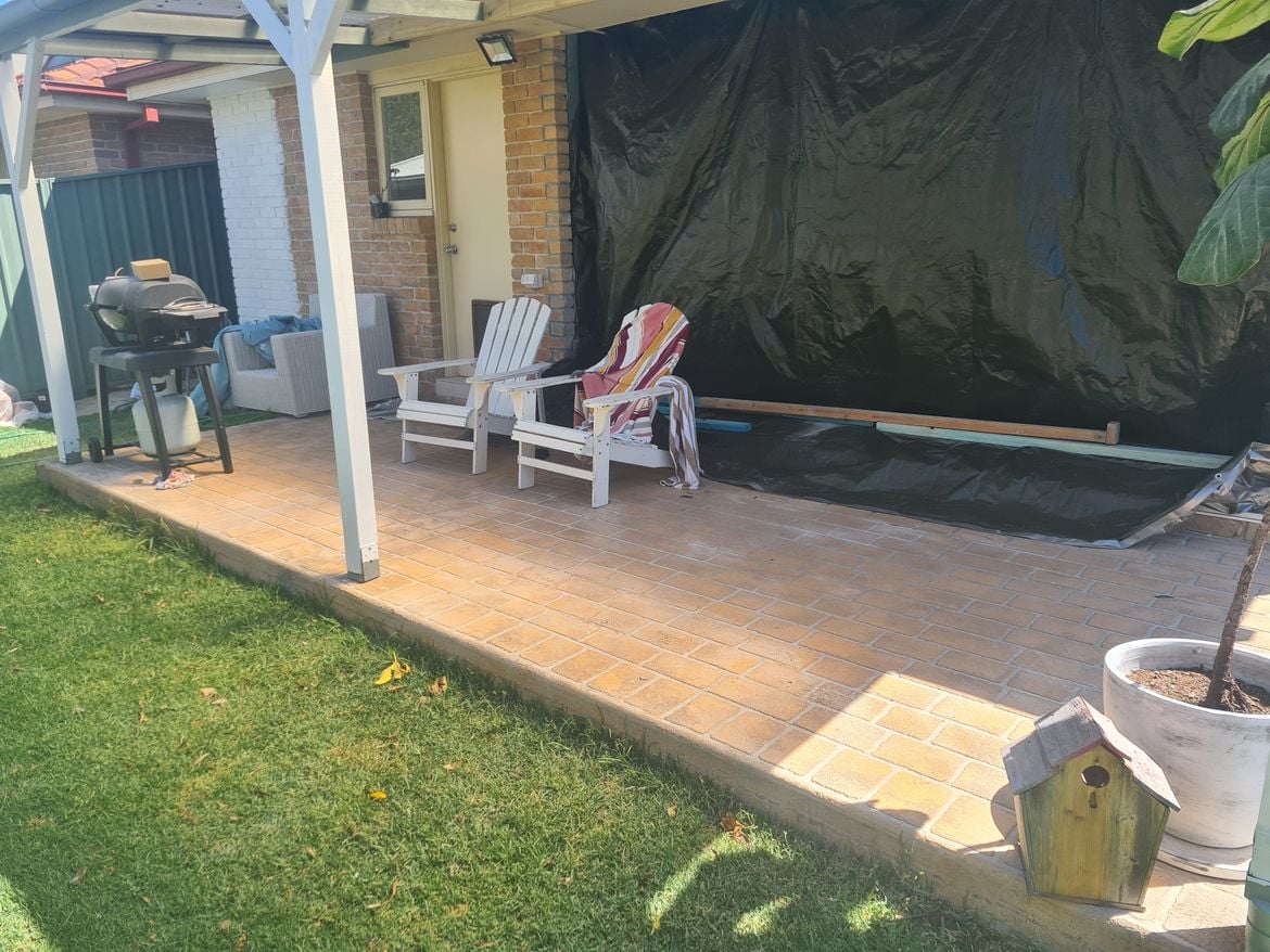

I am looking to build a low-level deck over the concrete slab extending from my house. The concrete is looking worn, and we hope to have the deck flush with new bi-fold doors installed. I have looked through the other related posts on here though have some specific questions for my own situation. Sorry if these have been covered elsewhere!

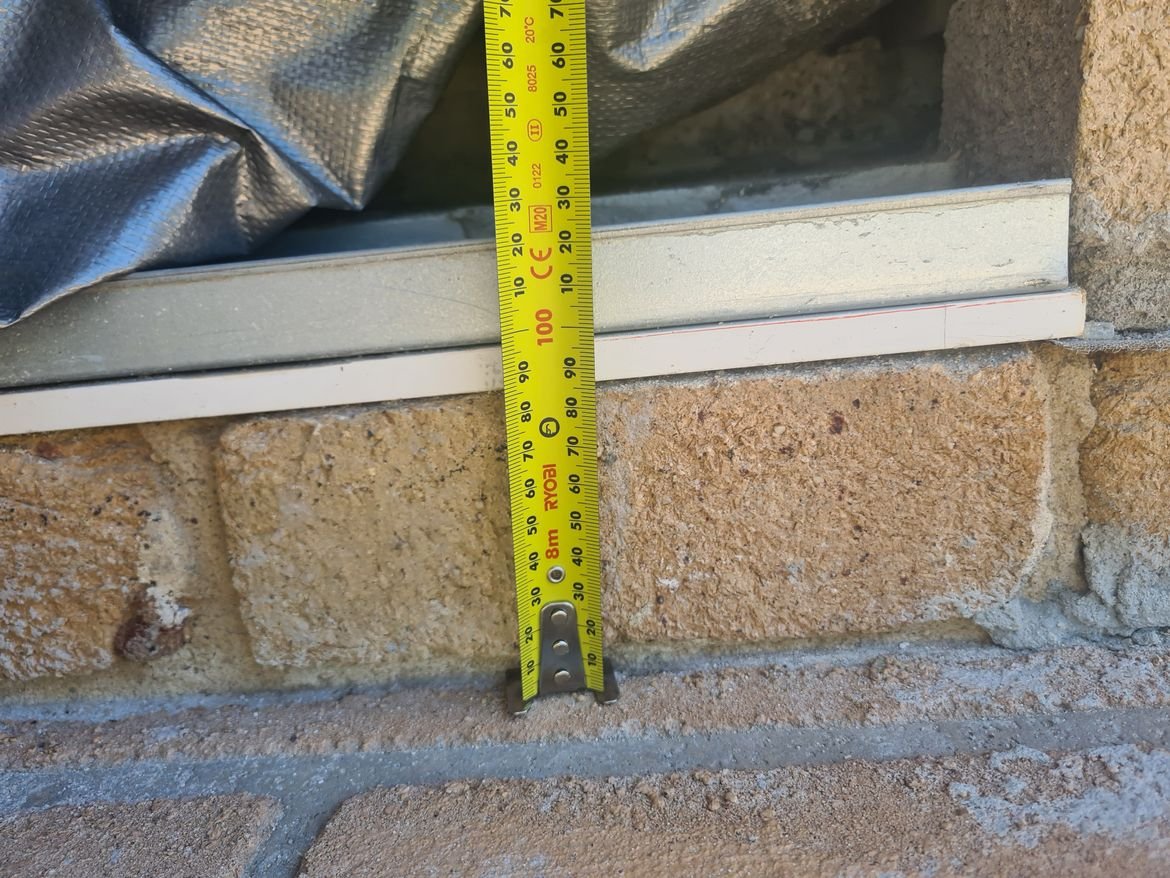

Firstly, I only have 120mm clearance from the slab to the level of bifold doors we are having installed. My plan was to use Spotted Gum decking boards (140x19mm), 70x45mm joists, resting on the "25-40mm Builder's Edge Pedestal Feet" (set at about 30mm to get the required 19 + 70 + 30 = 119mm depth total). My question is, how is it best to secure the deck to either the concrete slab, or to the house (and is this required, or can it be free-standing?).
The house is brick veneer, and the pedestal feet do not appear to have holes for fixing to the slab (I might have this wrong).
Next, the slab space to cover is 6.4m wide, and 2.5m deep from the house. I calculated ~15 joists required (at 450mm spacing) over the 6.4m length, and my understanding is that the pedestal feet should be no more than 500mm spaced, so there should be 5 spaced out across the 2.5m width. Between the joists, at what max span should my noggings be spaced? (I.e. can there be two rows of noggins ~800mm spaced?
Thank you, I expect to have many more questions as my project develops (Also, I know the pergola looks low with the deck added, this is a future job!)
