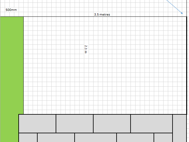

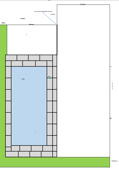

I am looking at 140mm boards running away from the house. Please find attached exel worksheet, the deck is not coloured (white).
There are 2 areas, which join.
Area 1, the biggest it is 3.7 metres x 11.3 metres
Area 2 (photo attached, the exel square represent 100mm x 100mm) is 3.5 x 2.1
Many Thanks, Simon

Unfortunately, I can't see a lot of the text in your images as the resolution isn't great enough. What's the relevance of the complex boxes/framing surrounding the blue area?

Sorry the boxes around the blue area are tiles, this was purely for my purposes when I was designing outdoor area.
