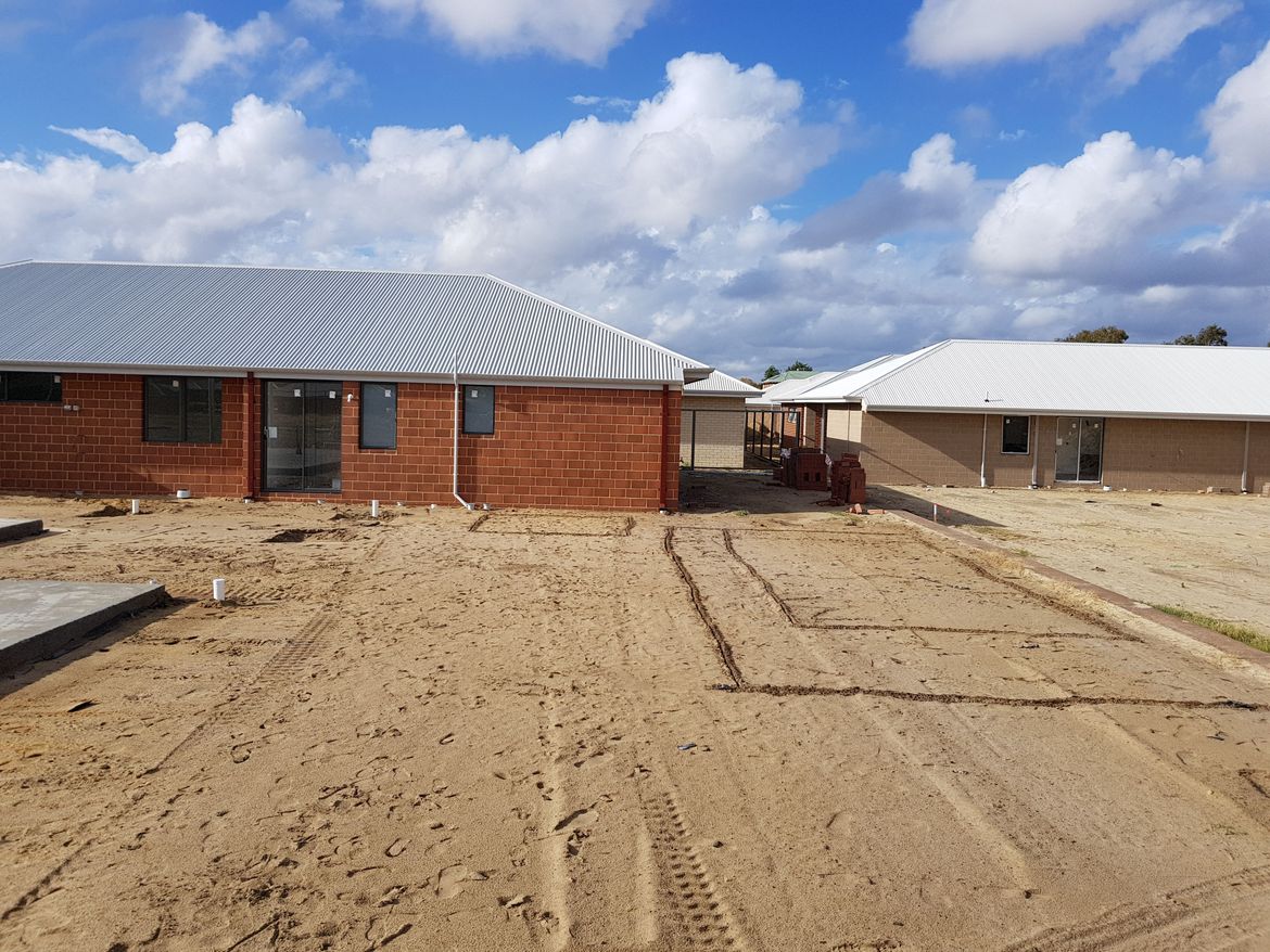

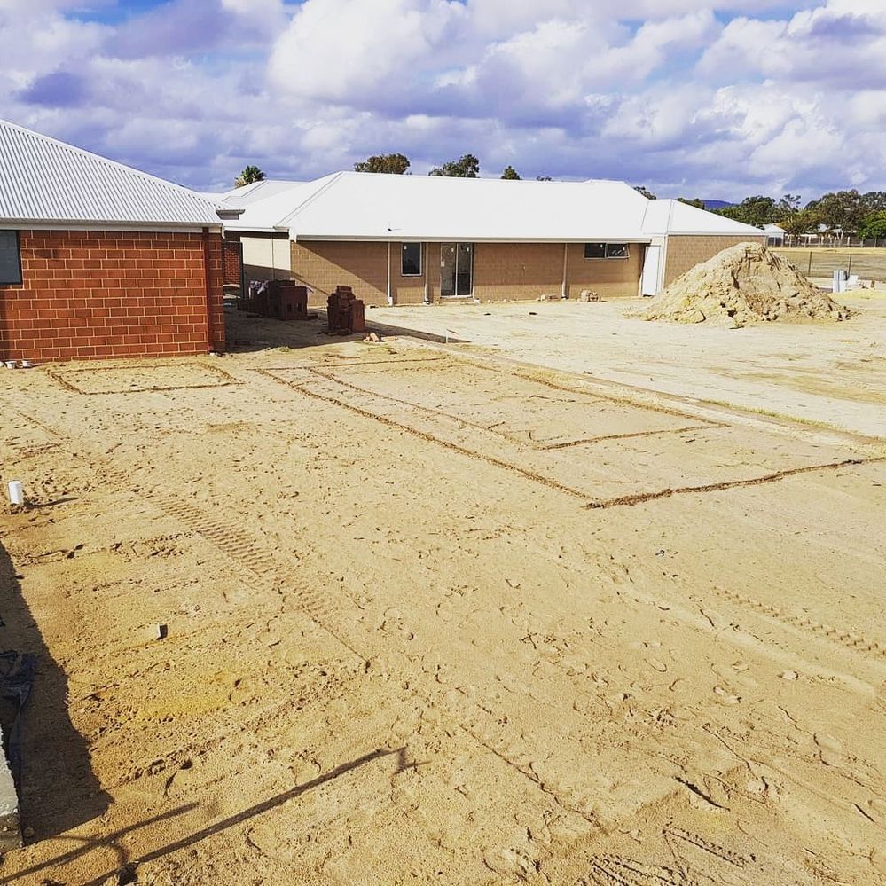

Below you can see where I've marked out the pool area and sunken firepit in our first crack at the sizing/location of the two. We're keeping the main entertaining area (6.5 x 3.6m Alfresco plus areas below) to one side of the yard while the rest is essentially for the kids and general play area including some garden beds, etc.
Back fence to back wall of house is 9.5m and the block width is 15m.
Pool = 7 x 3m. Total pool area is 10 x 4.5m (pool is 0.5m in from back fence and 1m in from side fence)
Sunken firepit = 2.5 x 2.5m
