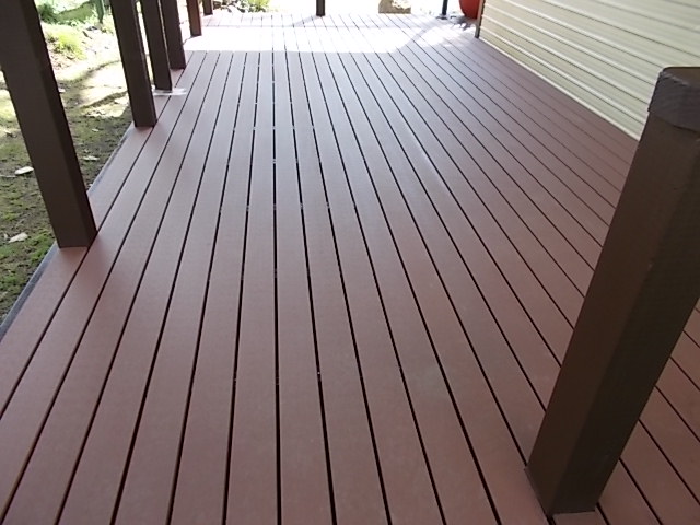

New deck using Ekodeck composite boards with the Quickfix hidden fastening system.

That looks awesome - how long did that take you to install?

Hi @maknilsin, thanks for your comment. I didn't physically install it myself - only ' supervised' over the builders' shoulder. Once the foundations were done and the metal posts were in it was pretty much plain sailing except for some stop/start because of downpours. Because all the boards were the same length as the proposed deck ( my way of cutting  the labour costs ) time was saved as well as money. The builder did the fixing while I helped by presenting the boards as needed. Deck size is 5.4 x 2.5 meters, and the boards were laid in 1.5 work days. And I just love it. Cheers.

@Trying, pure genius planning your deck to be the length of the planks, saving on labour & wastage.
You played your cards right, & have a beauty full deck. :wink:

Have you had problems with the deck getting hot at all?

It's fantastic to have you join us and many thanks for jumping straight into the conversation with an interesting question. As a general rule Ekodeck will retain more heat than hardwoods. Adequate ventilation between boards and under them is essential in reducing heat build within the product.

Hi Treble Trev, I've had the deck for a couple of years now and I'm as happy with it now as I was when it was first finished. The installation was done allowing adequate ventilation underneath ( most important ) and the nature of the fixing system for the boards also allows for great airflow. I should mention that I do have a roof over the deck but the sun strikes parts of the deck all day. My friends and family sometimes walk around on it without shoes and have never had a problem, but I always have shoes on. My biggest pleasure though is to sit watching my neighbours sweep, scrub, rub and apply coats of product to their hardwood decks each season, while I tinkle the icecubes in my drink. I love Ecodeck ! No nails to see, a sweep and a warm water wash, or just a hose-down if you only have dust, and it's good to go for another few months. Can't speak for others, but I would recommend Ecodeck  without hesitation. Good luck with your project Trev. Love to see some pics when you finish it. Cheers, Trying.
