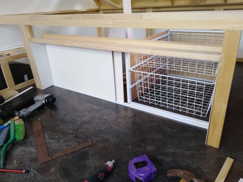

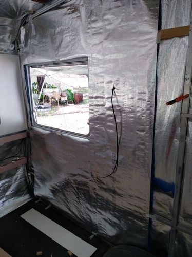

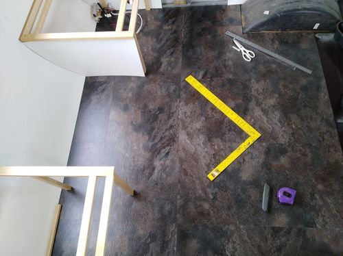

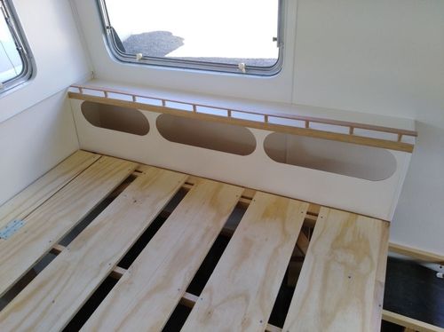

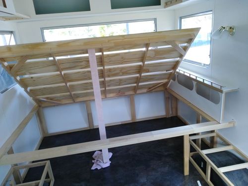

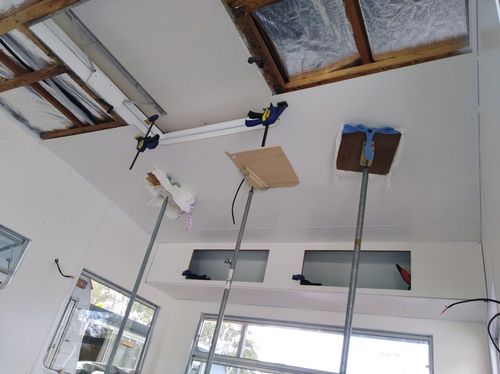

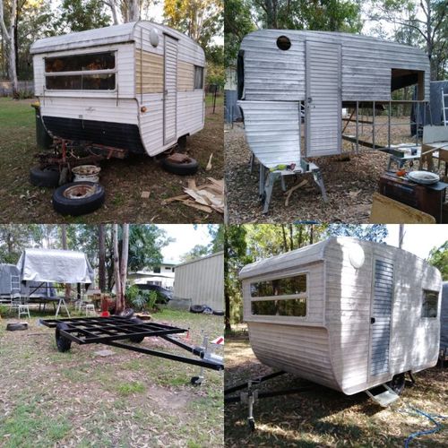

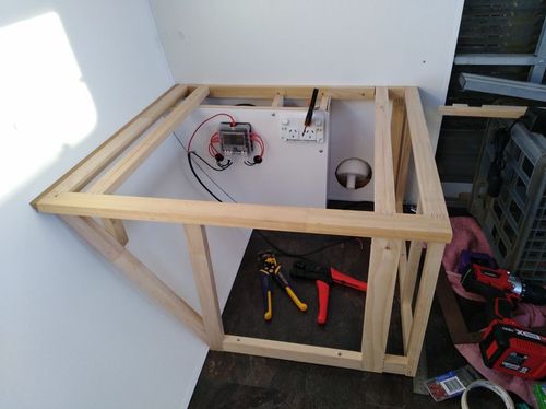

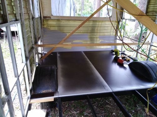

I got an email last night from Workshop with a few Caravan reno threads so thought I'd add a thread of my own now that I've made a bit of progress on it. I've been working on this little 10ft York caravan for just over a year, mostly just me but hubby helps with the mechanical side (he also rebuilt the chassis as he's a boily) and if I need a second pair of hands like when I put the ceiling up.
I don't have a trade, I am self taught and follow a lot of other renos on FB and Instagram. The only tradie I will get in will be the electrician to hook up a few power points and add a safety switch, I won't be fitting gas so no need for a fitter.
You'll see many items in the below photos from Bunnings, I almost live there. :smug:
20180514_115912.jpg   IMG_20180517_100603.jpg   IMG_20190128_090830_resized_20190202_090611741.jpg
IMG_20181108_144449_resized_20181108_052434230.jpg   IMG_20190309_130539_resized_20190309_045508418.jpg  IMG_20190616_132130_resized_20190621_081648926.jpg  IMG_20190705_114906_resized_20190710_075852360.jpg   IMG_20190720_071656_resized_20190720_071740364.jpg  IMG_20190802_135601_resized_20190807_064547640.jpg  IMG_20190802_121418_resized_20190802_123543078.jpg   IMG_20190803_120440_resized_20190803_073241237.jpg
This is where I'm up to now and will post more photos as I get the next stages done. Hope you like it :grin:
