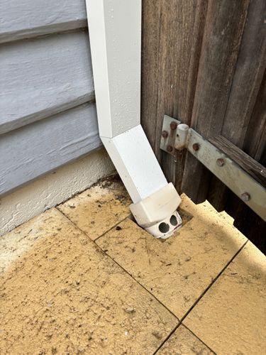

Hi all, seeking some guidance on whether there is a DIY solution to be had here, or whether I'll need to call in a plumber or soakwell installer.
Our house is a basic rectangle and has six downpipes - one on each corner, plus another two roughly in the middle of each long side.

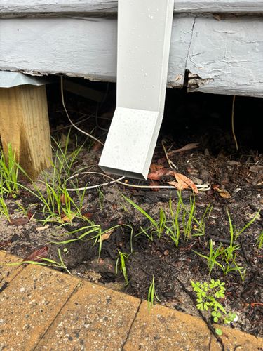

Unfortunately only two of these downpipes empty into a drain - the others drain onto the bare ground next to pine stumps, which isn't ideal.

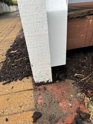

I've attached some images to show the driveway side of the house:
Driveway side - front corner Driveway side - front cornerDriveway side - back corner Driveway side - back cornerDriveway side - middle Driveway side - middleDriveway side - overall view Driveway side - overall view
The one downpipe that does empty into a drain sits about 10cm higher than the driveway - it's part of our rear patio.

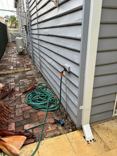

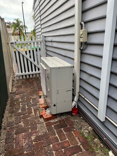

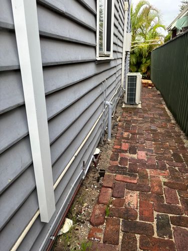

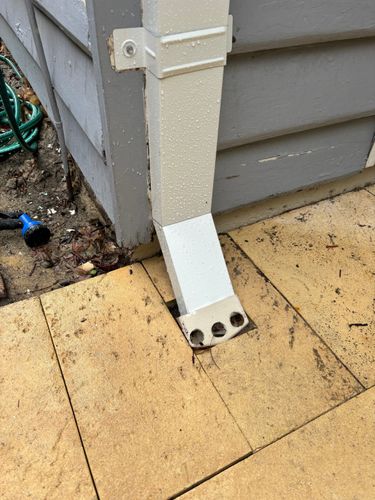

And here are some images of the opposite side (which is a tighter space, alongside a fence, with air con units in the way):
Fence side - rear corner Fence side - rear cornerFence side - looking rear to front Fence side - looking rear to frontFence side - middle Fence side - middleFence side - looking middle to front Fence side - looking middle to frontFence side - looking middle to rear Fence side - looking middle to rearFence side - front corner Fence side - front corner

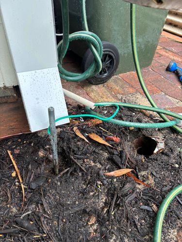

I'm not sure why that last one empties onto the earth rod, with what looks like an open drain hole 20cm to the right!
Thanks in advance - Damian

In this particular situation I suggest engaging the services of a plumber as they will be aware of the rules and regulations of the local council in your area. You'll also need the services of a plumber when it comes time to link the drains into your storm water drain.
In regards to your drains, I suggest thinking about using Everhard 3m EasyDRAIN Polymer Grate And Prejoined Channel in combination with Everhard 325mm Series 300 Shallow Stormwater Pit. This will save you from having to dig deep channels to install storm water pipes. Plus, it is much easier to maintain and remove blockages. I suggest speaking to your plumber regarding this option.

I would still suggest to have a plumber come out and have a look, to verify if the existing stormwater pipes are in good condition (Not squashed or have roots in them) Also to hit them up for where the piping likely runs.
Stormwater rectification stage 1
Stormwater rectification stage 2
Are my projects for my stormwater rectification. The pipes do not need to be super deep or have a super fall on them, tho for mine I just replaced and followed what was there before. The Downpipes that go nowhere for your place I would try and join them into your existing stormwater pipes (one reason for a plumber to have a look) I also went for the downpipe down to an open grill so there is a seperation for the leaves to get caught and blow away. (still yet to finish mine properly)
The earth post is for your house and really dont think the downpipe next to it is great (I had an old one next to mine as well so maybe it was a ruling years ago?)
Fence side rear corner is an interesting idea :smile: Not sure how good it is especially if the pipe is blocked and you wouldnt be able to tell as the water would flow out the holes?
Do you know where the stormwater pipes exit onto the street or down your back yard?  I have a stormwater exit into the street gutter either side of the house so it was easyish to follow them back to the first downpipe.
I also like the idea of capturing and reusing the stormwater (just to throw that into the mix :smile: )

Hi @damian22  am going to keep this simple . . . . .  call a plumber.
Every photo you have provided are of downpipes not connected to the storm water system, which is going to cause more damage if left to any other form of professional repair. This can only legally done by a licensed plumber. I'm also concerned about the last photo which shows your house electrical earth stake not correctly installed. This should be rectified by a licensed electrician.
Can I ask if this is a recently purchased renovated house as these are all non-compliant works carried out by what I am guessing non-licence trades? In which case you have a legitimate claim against owner builder insurance (6yrs).
