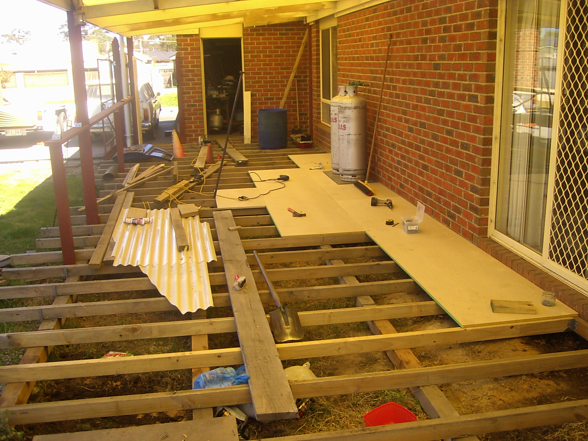

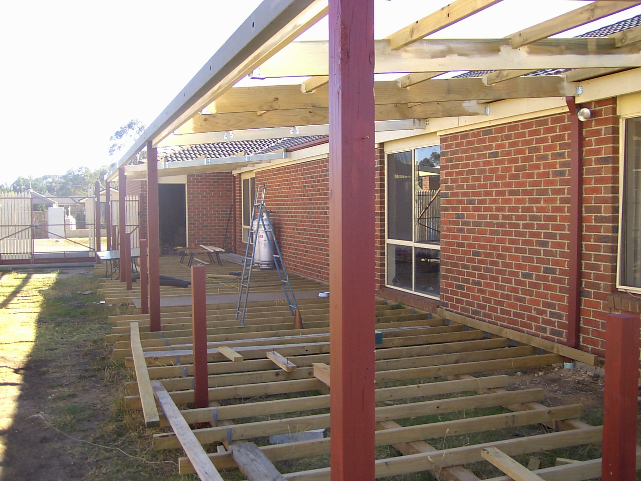

When we were planning our Pergola & Deck, we were originally going to use timber decking, but halfway throught the project we had the bright idea of tiling it instead. The drama then was that the deck framing had already been laid down dead flat. But as with any outdoor hard surface, you need some sort of drainage fall (rain doesn't always come straight down...).
My solution was to first lay down Green Tongue flooring (treated pine version of Yellow Tongue) over 2/3 of the deck that would rarely get wet, then lay black plastic, topped with varying thicknesses of cement sheet, 9mm cement sheet, 7mm bluboard, 6mm tile underlay, 4mm cement sheet to give some sort of fall for water run-off. The very outside perimeter was laid with 19mm cement sheet straight on the joists.
If I were to do it over again, I would lay a concrete slab first, no ifs or buts.
Halfway through the build...
Roof on (unseen), Green Tongue going down...

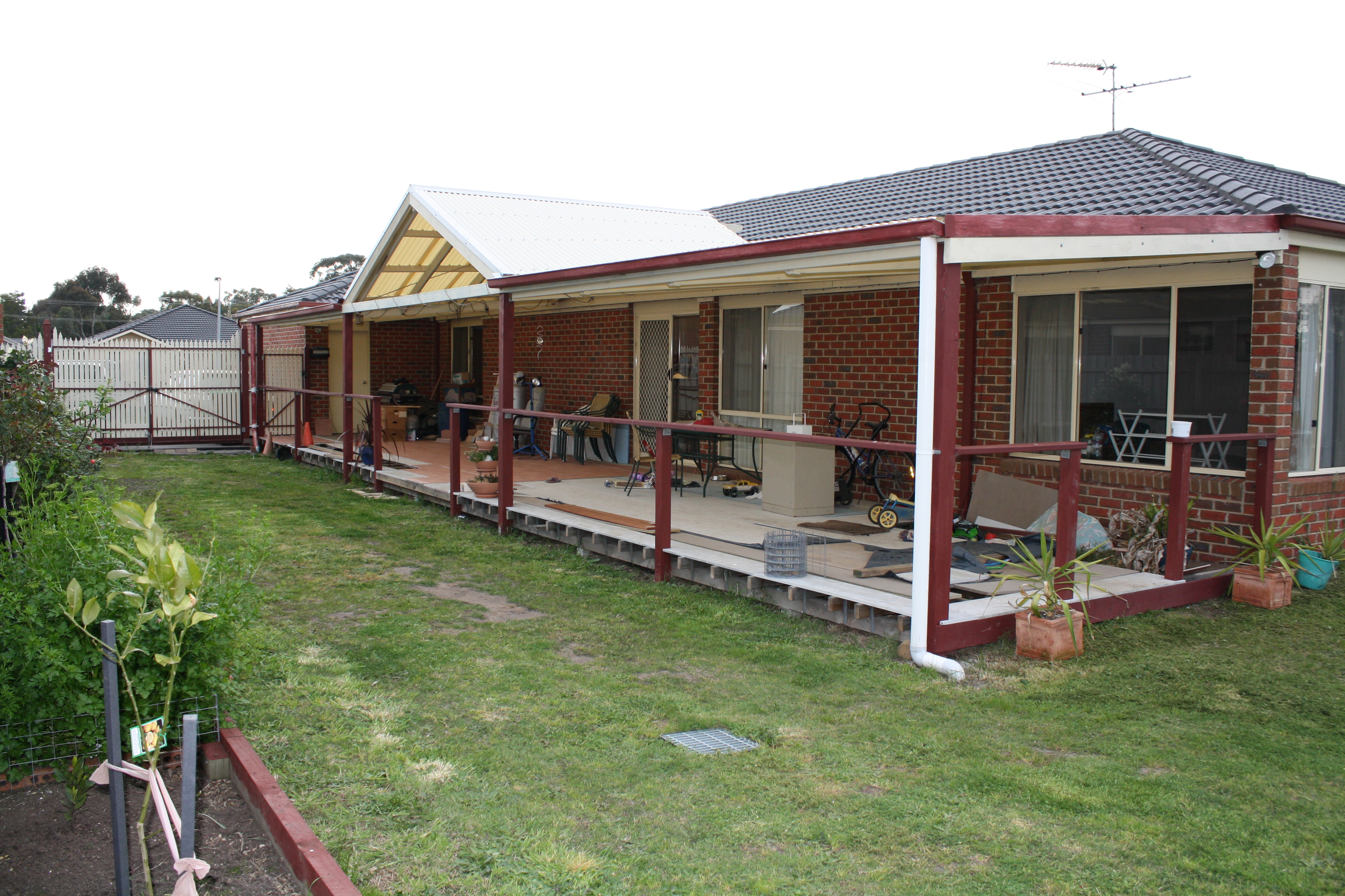

There's a bit more to this deck than you can see here, there is one row of tiles around the perimeter, then there's one row deleted which is filled in with Spotted Gum decking boards.
As I stated in my first post, if I were to do it again, I would concrete a slab to lay the tiles on and give it a slight fall away from the house for run-off. But so far, it's been nearly 7 years since this photo and there's no signs of any issues...
