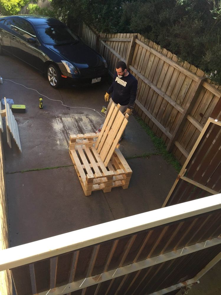

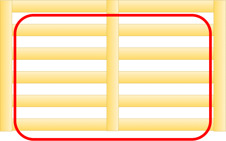

Get 2 pallets and cut them as per image
Keep 1 of the cut out parts as it will be used for a back wall.
Use 2 boards from second cut out, and reinforce/frame the first cutout on the sides.
Take the remaining of the 2 cut pallets and put them on top of the un-cut pallet. This will make the sides of the couch.
Nail all of them together.
Now it is time to use the sander. Sand all the sharp/ugly bits of the structure.
After sanding is done, slide the cut out part with frame before the second last gap closer to the back of the couch and voilà the couch is done.

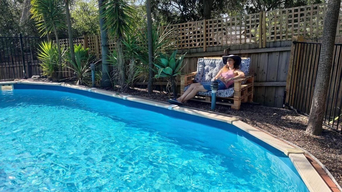

As an option, you can get 2 of this cushion: https://www.bunnings.com.au/mojo-blue-and-white-marrakesh-bench-cushion_p0285756
they fit perfectly as the padding for bottom and back of the couch.
Here is the result product:
Hello @den1ska
Thank you so much for sharing your outdoor furniture pallet project. I can already tell that this is a successful furniture build as the person using it is totally relaxed. Plus, your location in front of the pool is perfect as the sound of the water is always calming. Did you use 4 pallets in total? Will you be painting the pallet in the future to extend its usefulness?
Just in case you are looking for more pallet projects here is a link to ideas and inspiration: Top 10 most popular pallet projects.
Again, thank you for sharing such a fantastic project.
Good day @EricL,
The total is 3 palettes, 1 uncut and 2 with middle being cut out.
4 can be used too, if you want to raise it of the ground.
Thank you for the link for more ideas!
