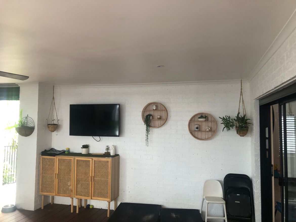

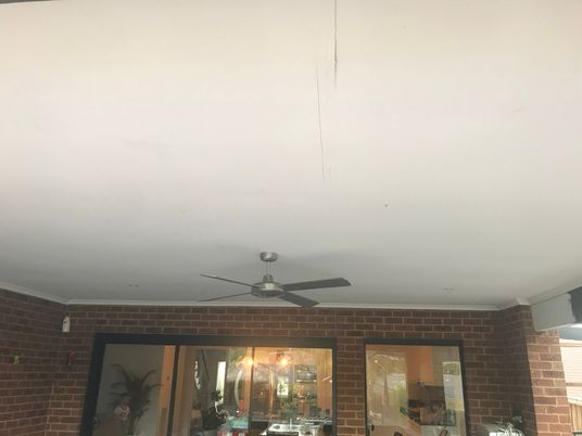

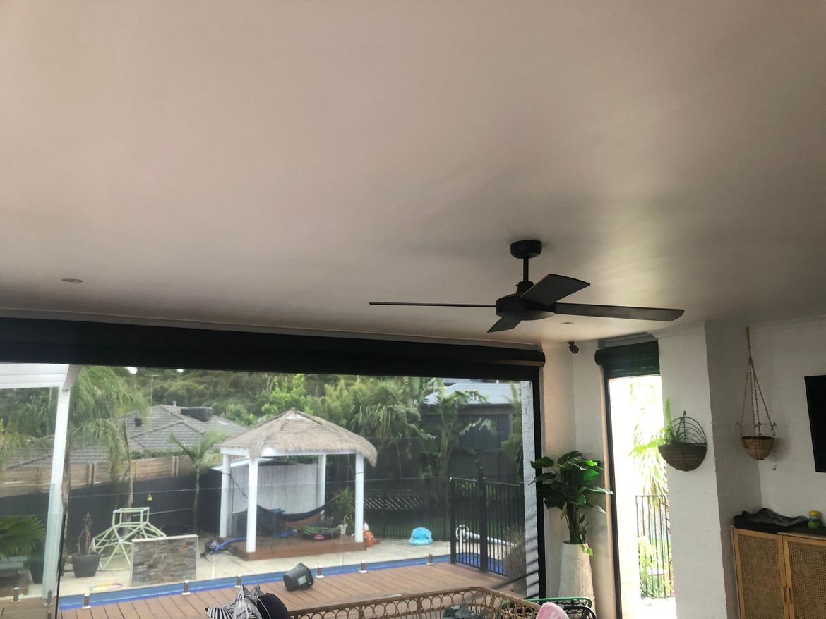

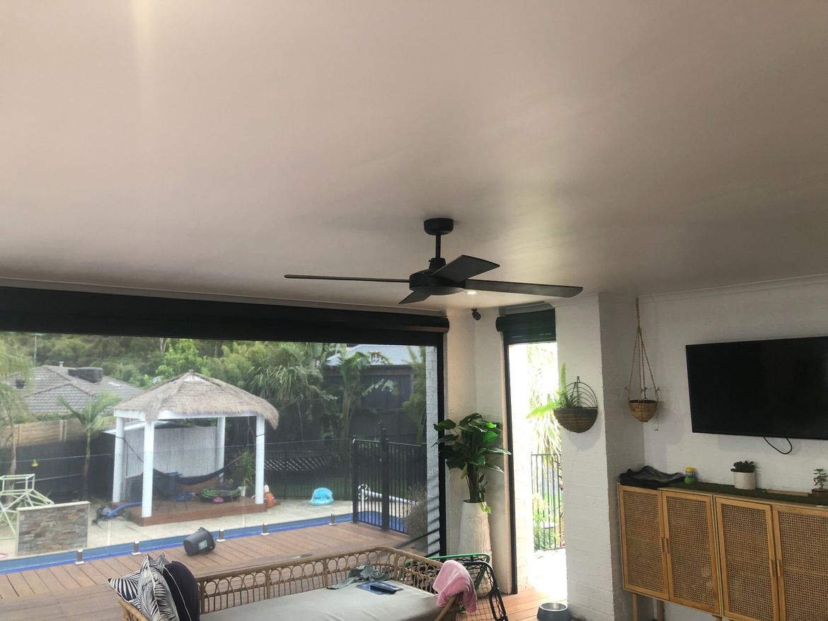

Have a outdoor Alfresco with a Plaster ceiling which has started to crack and split in the joins along with nail holes starting to show, I think the exposure to outdoor weather has created the issue the house is about 12 years old, I was considering removing the ceiling plaster and replacing it with a white coloured timber.
Would love to hear thoughts on the following
1.Timber cost versus plaster I am assuming plaster is cheaper and would a timber product be ok?
2. What timber product should I look at, or is there another solution?
3. How difficult would a project like this to complete for a amateur?
4. Alternatively should I just repair it and repaint the ceiling?
5. Also considering putting heating on ceiling but this does not need to done now, any thought on a product?
Ceiling is 5670 x 5640
Have included a couple of pics but they don't show the real condition of the plaster clearly.

I don't think plaster board is suitable choice for an outside area. You would be better off using fibre cement panels. Timber lining will look great but will cost more. T&G strips recommended so that the boards will stay locked together  not warp.

@pnaylor Budget permitting I'd suggest looking for a timber/composite lining/cladding to a) fix the problem and b) create a feature in your alfresco space. To do this you'd fix timber battens to existing roof joists/rafters then attach the lining/cladding to those. Skill wise I think it's appropriate for an amateur with the right tools and instructions.
However your most cost-effective option is going to be a targeted fix on the affect panels. Depending where the issue is you could just remove a section, tape a new piece in then patch and paint. Or you could be looking at replacing whole panels.

It's great to see you've already received plenty of helpful advice. I'd suggest the first thing to do is scraping and sanding back into this area to find out what is going on. This might be a case of simply screwing a sheet back into position and re-plastering the seam. Plaster in a humid environment swells and contracts and cracks form at joins where there is movement. Your timber idea is something worth thinking about, but I would encourage you to first determine if this is a major issue or just a simple repair.

Ended up repairing the Ceiling added more screws to secure it peeled off old plaster joint tape and replaced it, I then had the issue of the paint peeling away had to scrape away sections and repair with plaster fill, it looks as though it was never undercoated properly when first built, painted with a weather shield paint to help protect it I guess time will tell fairly happy with the result but was a fair amount of work.
