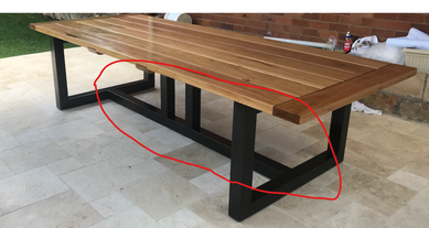

I was inspired by this Custom Industrial Table by @ogosh for my outdoor / backyard deck.

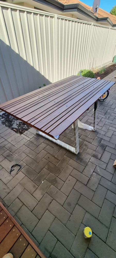

Contrary to @ogosh situation, I could not source any good quality of this Pine Sleeper. (cupping or crook). Therefore I went with merbau fence panel Merbau Fence Panel
And frankly, I am a bit intimidated while working with cupping timber 👻
Earlier I built a low level deck and encountered many difficulties with cupping pine and deck timber.
But lessons learned, for sure.😃
I added bearers on top of leg table to line up with the table leg hole 3x 2 holes per leg.
It added approximately 40 mm of total table height but still maintain a reasonable height when sitting on the bench.
Completed by placing the Merbau Panel on top of bearers and secured it with bolt and nuts.

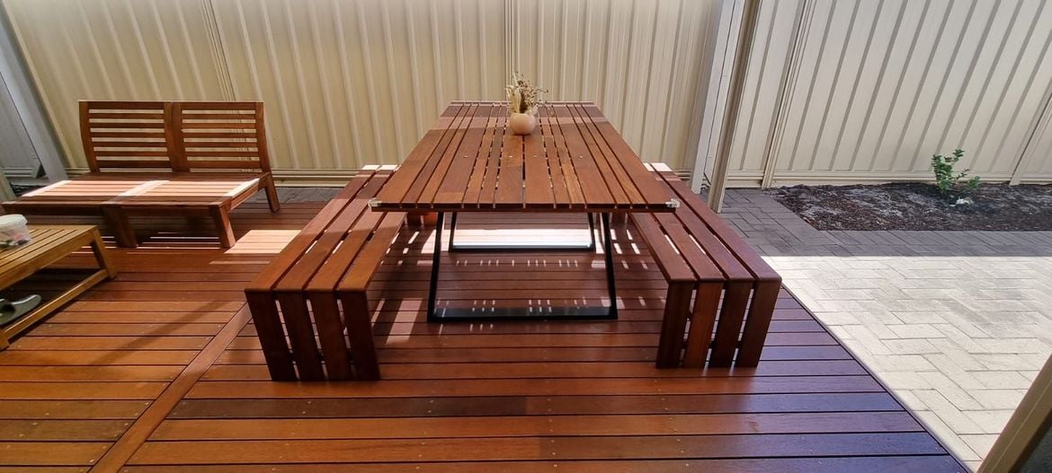

Placed in the deck with 2x Mimosa Merbau Bench .
