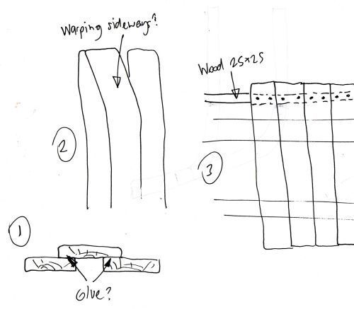

Anyone have experience glueing back paling? Would Gorilla Glue hold it back in place?

Hi @Prof - thanks for the response; warping alongside the adjoining palings not the rail and overlap of palings isn't much hence trying to avoid screws.

Overlaping as seen in No.1?
Are some of the boards bending sideways as in No.2?
All I can think of is screwing all the top ends of the boards into a piece of wood at the back - and painting the exposed unpainted edges.

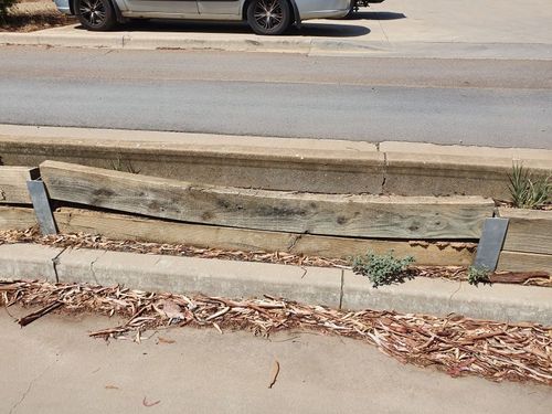

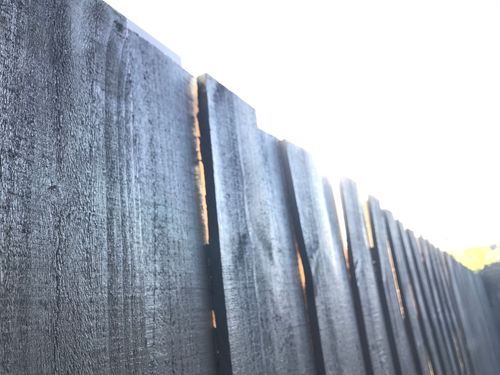

The power of pine warping.
Seen at the delivery end of the local Bunnings store...
Thanks @Noyade - good illustrations, exactly like No. 1. I am able to push them back, hence I was thinking of using strong wood glue (with a clamps until dry).

@mike88 Replacing them is probably your only sensible solution. If they've dried enough to warp they'll probably split if you try to flatten them back out again. The main problem with treated pine palings is that they are sold as "wet" timber and not kiln dried. I've seen 100mm wide palings shrink down to 95mm when they dry out and if they're not secured from every possible angle they'll twist up like a piece of licorice. That's why they're only $2.00 each.

If you use the horizontal rail idea. Try putting the nail in well away from the edge to avoid splitting. Place it so the nail goes in beside the inner palings. The pressure from the outer paling will keep it flat. Pre drill the holes and use screws for an even grip. I hope my picture makes sense.
