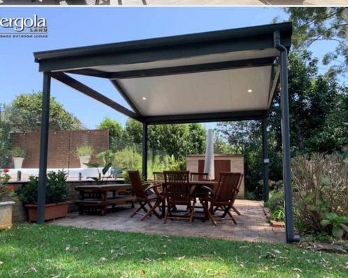

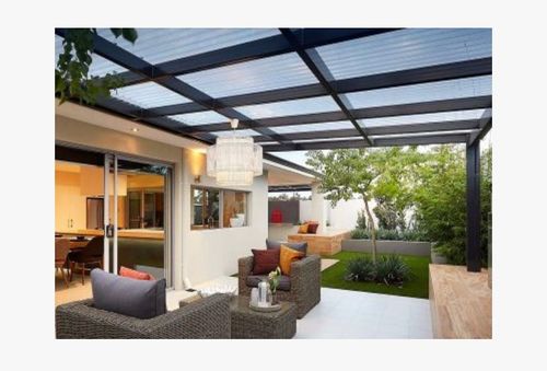

I have attached some photos of ideas I think could be a realistic to replicate also the internal framing.

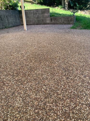

Also any suggestions to change the look of the floor?

To change the look of your floor, I recommend using Megatreat. It is a long-lasting selection of unique aggregates, sand, and special acrylic binders which can be used to create real stone finishes on floors, walls pots, timber, or any desired surface. Based on the photos you posted, you also have the option of painting the frame in a dark color. However, please be aware that putting a dark colour on your frame will tend to make it look smaller.

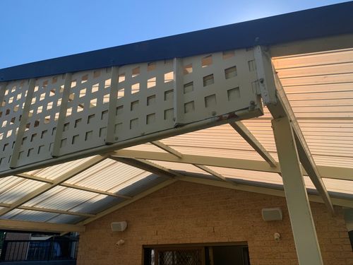

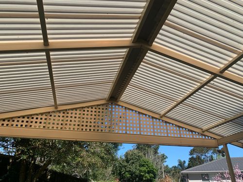

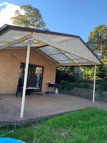

also would you be able to comment regarding Mitchell post “We'd need to see some images of the internal framing to tell if removing the trellis would be an issue” I have attached the photos of the structure above .

It's a bit hard to tell if that trellis is a structural support piece or is just a design feature. Looking at your other photo, I suspect it is a support piece as it goes under the roofline. It might be some sort of bracing. I suggest leaving it alone and not remove it, just to be on the safe side.

Have you tried pressure cleaning the concrete? This would probably make a big difference too. We recently had a Jim’s pressure cleaning come do our huge driveway it was $170 and completely changed the look of the front of the house. If not wanting to change anything structural to save on money and unable to move the trellis I would paint the trellis the colour you want and if possible add something to the back of it like a fibre cement sheeting and paint it a contrasting colour. It would feel much neater when sitting under neath. I would also add some screening to one side to close it in a little bit as it’s very open then you can out things like the bbq up against it. You could add some greenery to the screening or even herbs etc that you can use for cooking. Bunnings have premise screens so you could pick a design and then just build a frame to the existing pergola and attach them.
