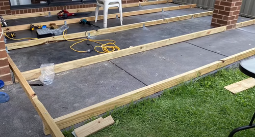

I am in the process of building a deck in my alfresco.
i would like to clarify, is it ok for me to build it this way?
the spacing in the picture is not correct. i was thinking 400 MM between each wood and then the deck boards go on top of it?
will this work? or should the base frame be above the ground? I.e not touching the floor?
Thanks a lot
Re: planning and building a deck
Hi @shawnvaz,
Spacing your joists 400mm apart would be fine to lay the decking upon. It's best to have the joists elevated above the ground to allow airflow to the structure and water to runoff. You could use the brackets you have now and elevate the joists 10mm off the ground. That would be much better than having them sitting directly on the ground. You might like to use some Macsim 75mm Mixed Hang Window Packers to assist in getting the correct height.

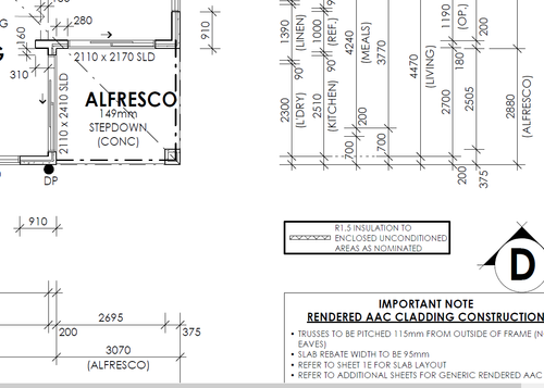

I am trying to deck the alfresco area. but extend the deck a bit over
this is the area i am planning to deck

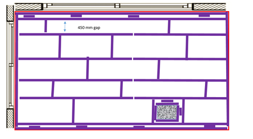

below is the pattern i am aiming
Thanks
