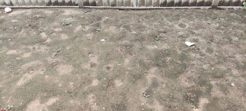

Need hints on how to prepare the turf for installation of grass. Small area approximate 10m by 3m.
I am not sure where to start, so more details, more helpful. I have some weeds growing in there so expect to put the weed killer a before I start preparing turf, but I am not sure what all steps / tools are involved in that

I trust you found the supplied step-by-step guide useful. You might like to show us an image of the area you wish to lay the grass on. Is it relatively flat at the moment? If you have any holes, you'll want to fill them up with Brunnings 20kg Landscape Paver Sand, and it would be a good idea to do a 50mm coating over the entire area and level it with a Saxon Top Soil Spreader.

 You ouderstood it right the first time. Thanks for the guide for laying down the turf, I was actually looking for prerequisites before I start laying the turf like how to level soil, do I need to install any sheet below the turf to further
reduce growing weeds

As I've mentioned above, you need to establish a flat surface and infill any holes with sand. No additional matting needs to be laid as the grass comes with a rubber backing which weeds cannot grow through.

Thank you,  so I believe that fill any holes, level the surface and then install synthetic turf as per the link should suffice?
Re: Prepare the turf for synthetic grass
That's about it @newbie3486. I've laid synthetic grass several times before and those were the steps I took. The grass is still perfect several years later.
