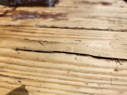

The floor sander looks like the go but a bit beyond my capability. I'll use the orbital but what size grit should I use? Also, there's one spot where there's a chunk of loose wood n what do I do about that?

Re: Pressure clean sand and stain outdoor deck
Hello @Jeanagh
Is that a giant splinter in the middle of the decking panel? When you mentioned a chunk of loose wood is it actually a strip of wood that's come off? That part will need to be sanded well and I suggest using Intergrain 180g Jarrah / Merbau Woodblend Putty to fill in the gap in the wood in combination with Trojan 50mm Paint Scraper. However, if it looks like the wood has started to rot, I suggest spraying it first with Earl's 250ml Wood Hardener before putting the filler in the gap. Please make sure that the wood hardener is dry before fixing the gap.
In regards to the starting grit, I recommend using 80-grit sandpaper to remove the old paint. If it looks like it is not taking off as much paint as you like you can proceed to a lower grit number. For the finishing grit, I suggest using 240 to give you a nice smooth finish.
