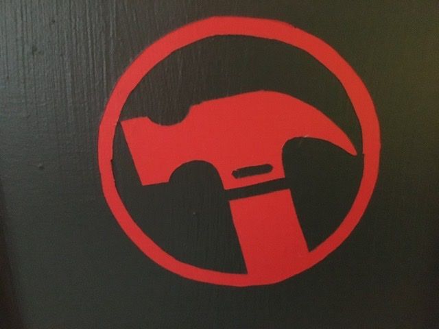

the Bunnings logo is about 70 mm diameter was made by painting surface red two coats, then made stencil with masking tape and then a coat of red to stop bleed through, and then two coats dark green WOW look at how clean that came out no bleed through for this I used SAMURAI razor edge delicate masking tape
