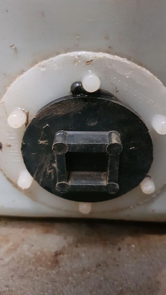

A small leak has started from low bung in 5000l water tank, new house, tank is approx 5 years old. In photo you will see that the bung was maybe over tightened on install (see o-ring that has bunched up near top). I suspect the bung may have been knocked by one of the kids parking a bike & this was just enough to start a slow drip leak.
Question is - can I just tweak this a little tighter with a wrench? or, any other more sensible solution?thumbnail_20210202_142814.jpg

You might be correct that the fitting was over-tightened in the first place, or perhaps it has been tightened already to stop a slow leak. The rubber o-ring appears rather pinched, and tightening the fitting further is likely to make the drip worse.
It would be best to look at either replacing the o-ring or backing the fitting out far enough to add thread tape instead. I would imagine the current o-ring is crimped and set into that shape, and you won't be able to use it.

Thanks Mitchell - appreciate the advice. I'll wait to see if your mates have anything further to add, otherwise, I'll proceed with the backout & thread tape attempt at fix - any idea on how long that thread on the bung might be?

It's a bit hard to tell as there is no generic length @Garvo. I'd hazard a guess that you should be all right backing it out until you see a centimetre of an exposed thread. Any further and you'll risk it coming out completely. Overall, it might have 20mm of thread.

I think Mitchell's approach sounds good. Maybe have a large rubber ring seal handy too, which you may be able to stretch over the bung, in case that existing seal comes apart when you back the bung out. Optionally, can the bung be replaced with a tap?
I replaced my tank tap last year...  a bit messy, but I found that by attaching a long hose to the new one first & having the tap open (so ur not fighting against water pressure & the outflow isn't all over you), I was able to get old one out and new one in quickly & with very little water loss. (A minimal  drowning.)

Thanks TedBear - good idea RE: having a large seal on hand to see if I can stretch it over. The tanks are already plumbed to garden taps, internal water to toilets etc - so probably won't go the tap route, but I get what you're saying regards using the hose/tap to manage the pressure for install & may visit this if I can't get the bung to seal.
