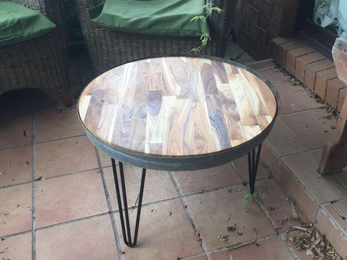

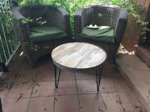

 I completed this morning a coffee/occasional recycling hoops from a degraded wine barrel fitted with a teak fj glulam round panel.  I couldn’t locate them via the website but went in store at Belconnen forty minutes later the table sits on my veranda

What an excellent use of materials. Did you use the Taskmaster 400 x 10mm Hairpin Steel Table Leg? It blends in so well with the wine barrel hoops. Will you be putting any sort of protective coating on it to protect it from the elements? Did you glue the hoops onto the timber or are they just tightly fitted? It's a fantastic looking table and I'm sure it will provide many years of service. If you have any other projects ongoing, please don't hesitate to share them. Any updates you can provide would be much appreciated.

Hello I used three of the legs mentioned and used galvanised self tapping screws to attach them to the base.  The base has been attached to the preexisting coopering pins which are part of the barrel hoop.  I’ll apply linseed oil to the top.  I use raw linseed oil diluted with turpentine to apply with a pump spray bottle.

 I have applied a coat of raw linseed oil diluted with turpentine to the table top

How wonderful @rgoyne! That really has bought out the grain and beauty of the timber. I'll have to try your raw linseed oil and turpentine mix sometime soon.
